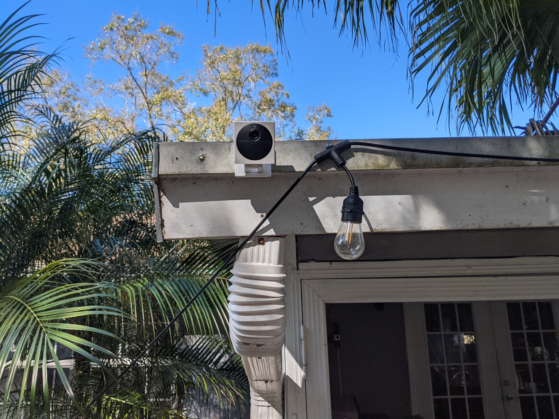

Any heat source next to the camera that might trigger it?
You can simply send an email to our support email address with a short description of your problem and you should receive a reply from Wyze with a support ticket number. Pls send that to me once you get that.
I do have a string of lights near it, but there are rarely ever on unless we call them on via Google when we go to the back, but they are never on long enough and and shouldn’t be hot to even affect the camera. Sorry didn’t get the picture of the setup, I’ll do my best to get it this time. And thank you for the instructions, I thought it was something within the wyze app.
Noted! Thank you. So you don’t think there’s a correlation between the lights and cam triggers, for instance, date 1/15. How far is the light from the cam? Love to see the setup image but no rush. I’ll wait for your ticket number. :slight_smile:
Issue sent to support👍
I wouldn’t want to guess the distance, but I do know the cam is much above the string of lights like they’ve always been before having any issue.
@WyzeLi here is the pictures/ setup. It used to be the driveway cam until I purchased the flood light. Than I transferred it to the back where it was good for a long time, until this new issue.
