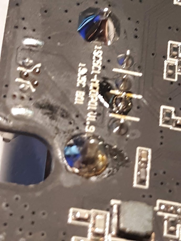

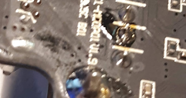

ok as promised here is my follow up post ā€¦in this first picture there is a contact that is clearly fused with the one next to it.

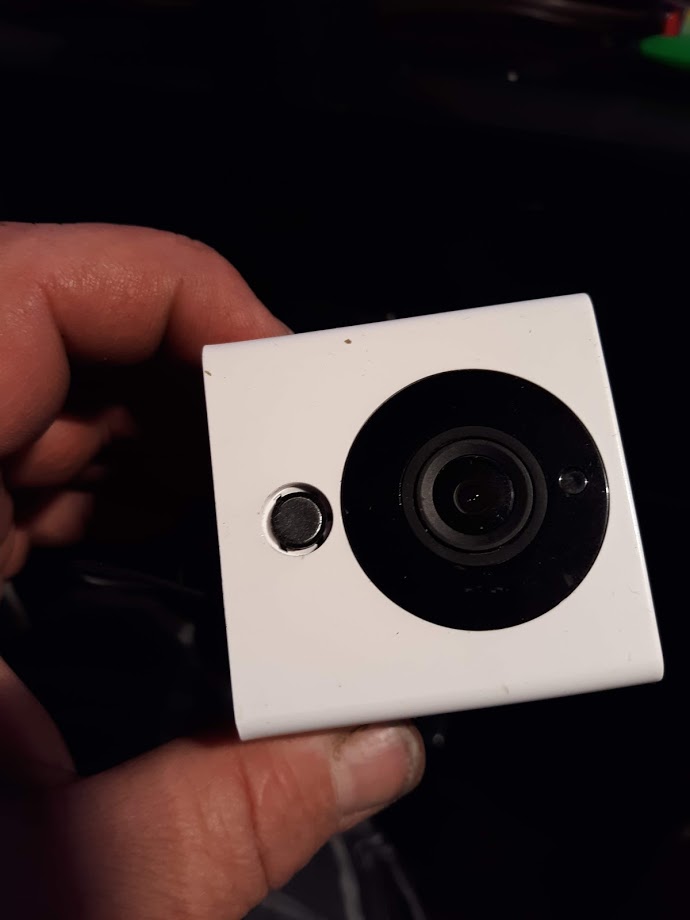

in this picture the mic is clearly off center and I must say it is so far recessed from the hole they provide for it , it makes sense as to why some people have horrible audio,

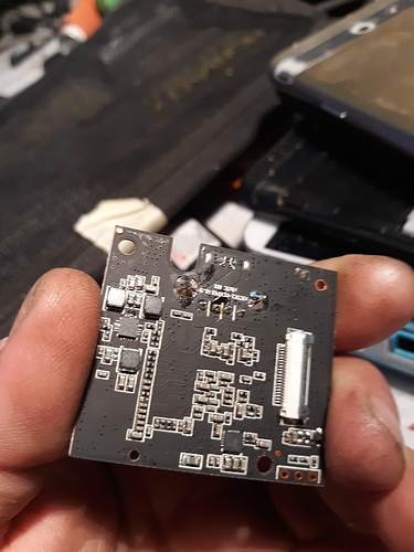

So as Ive said this camera got hot! to the point of not working and i believe that there is a QC issue with what ever plant makes them. In this next picture, you will see partly why.

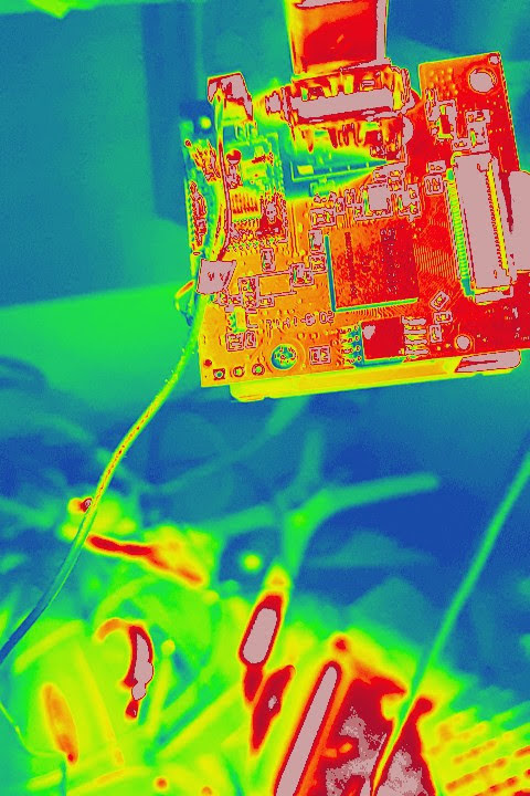

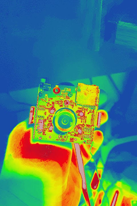

I found the wifi was getting hot where the chip and antenna wire e met the board.

ok soā€¦ yes I do believe giving the rite circumstance s yes I do think this little unit is more than capable of setting its self on fire,

  2. the square lens was allsorts of dirty and had a fingure print on the inside (I just cleaned it and that required the unit to be disassembled also to do so)
  3. The Microphone in the unit was off center and if you look to the left you will see another hot spotā€¦
    ( I Replaced the mic with a larger one and prperly seating it in the provided pre cut mic hole.
    Now I can he people about 5 houses down while there inside!!)
