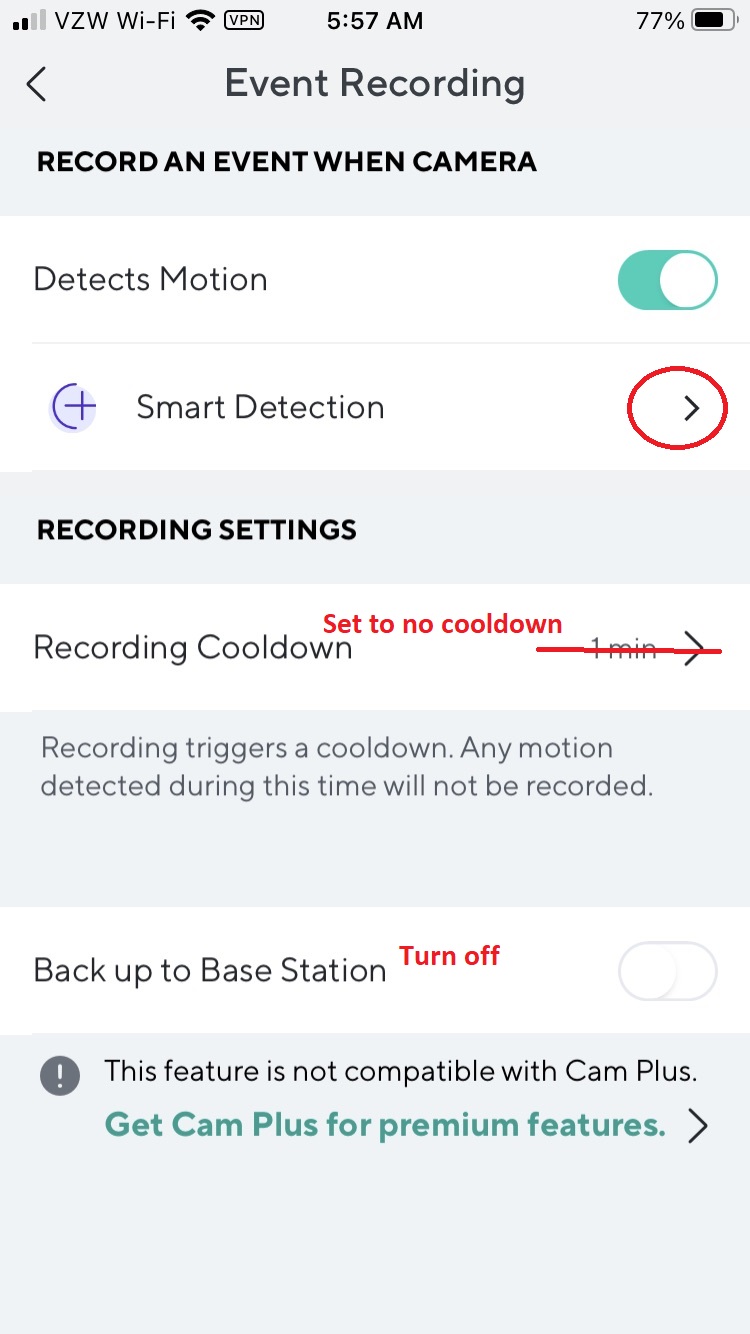

Since I do not have CP on my WCO any longer I can not show all the settings I had. On the app open the cam>tap the gear icon and go to settings, Event recording>detects motion on, set cooldown to no cooldown, turn backup to base off because it will not work with Cam Plus anyway. Go up and tap on smart detection and turn on all the AI events.

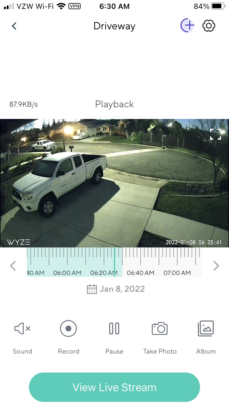

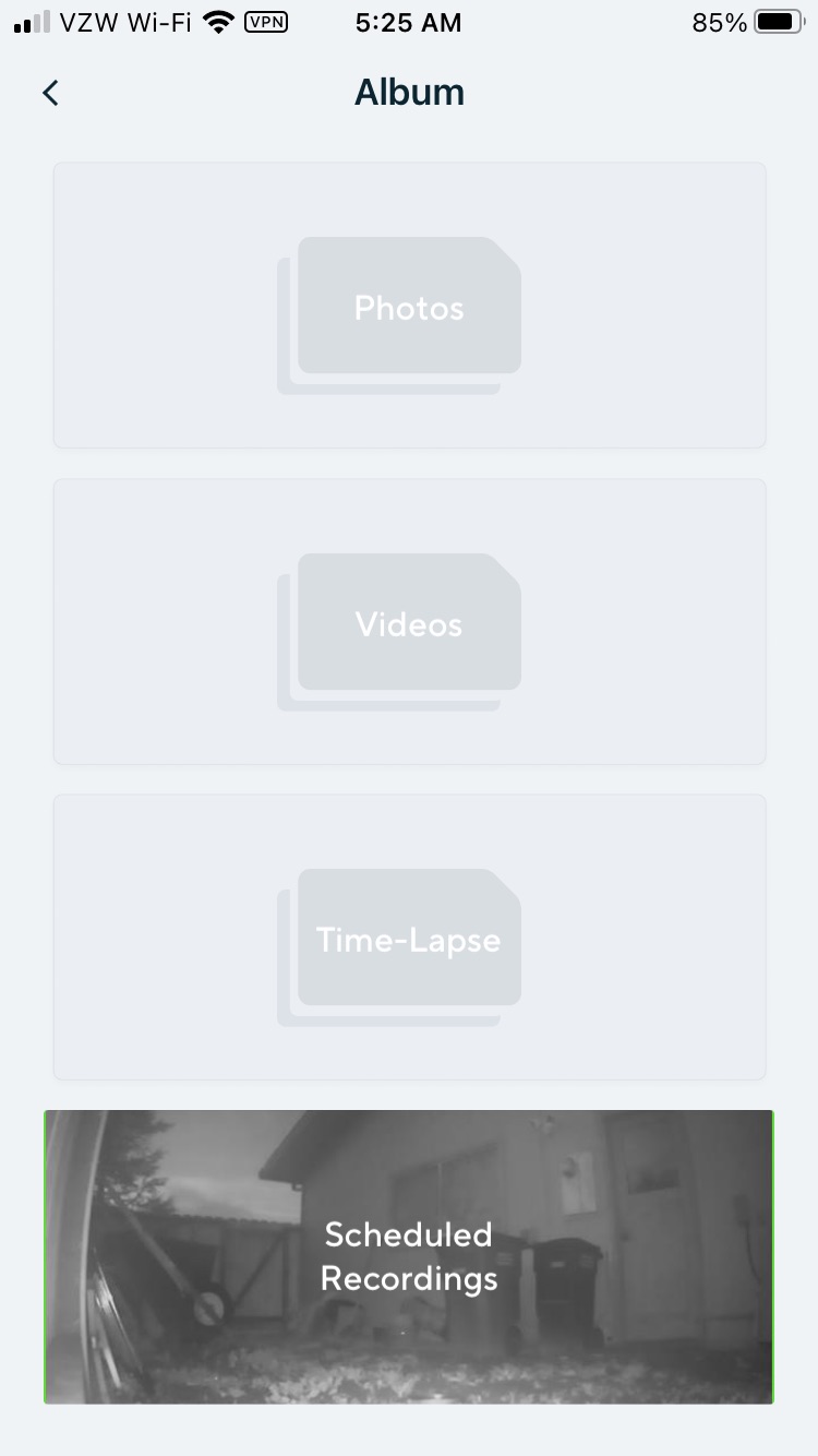

I don’t think there is a “Playback” feature with the WCO with Cam Plus like on the V3 and others because the WCO is not recording events to a SD in the camera. The only event videos you get are the cloud events on the events page. Do you have events showing on the events page on the app? The playback from my V3 is from the installed 64GB SD card not the cloud. I have videos on the SD cards in my 4 WCO because I do not use Cam Plus, I use scheduled event recording and they can be found in album. If you are talking about what is shown in my second picture below you are out of luck, it does not exist on the WCO.
