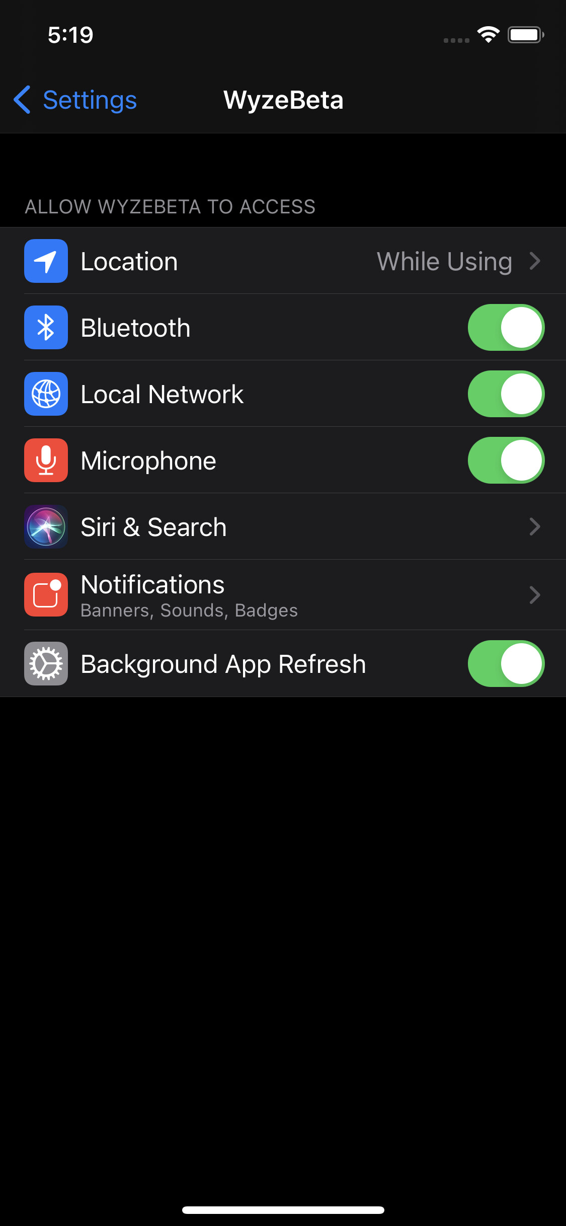

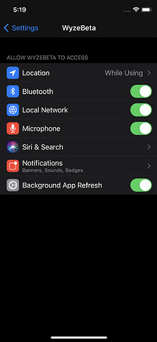

Also, here are my settings for the Wyze App. Something to check.
It very well may be your router or a network issue. I went through 2 different routers before things stabilized on my network. I was having sporadic issues especially when events were occurring and I wanted to see the live stream. Since switching to a new Router, my issues have went away. Plus it covers greater distances. I have read articles and even have proven with my testing, turning on Trend Micro on the Router caused an issue for me and others. You can always go into the router and turn it off to see if things improve as well.
