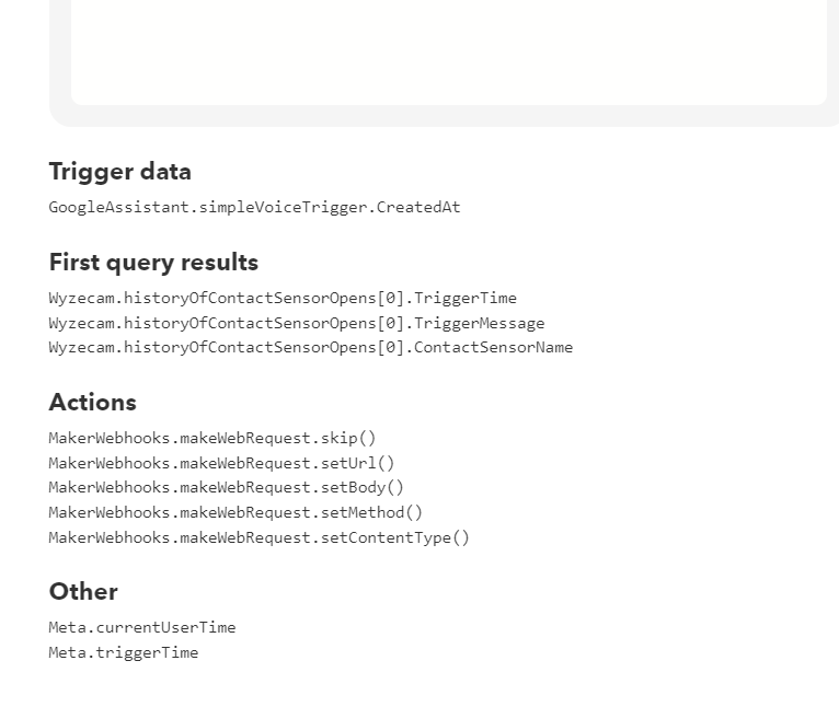

Using Google assistant for “IF”, selecting “Wyze” for “Add Query”:
Subset options under Wyze
Then you must add your then, and then go BACK to add a filter
filter code section.
