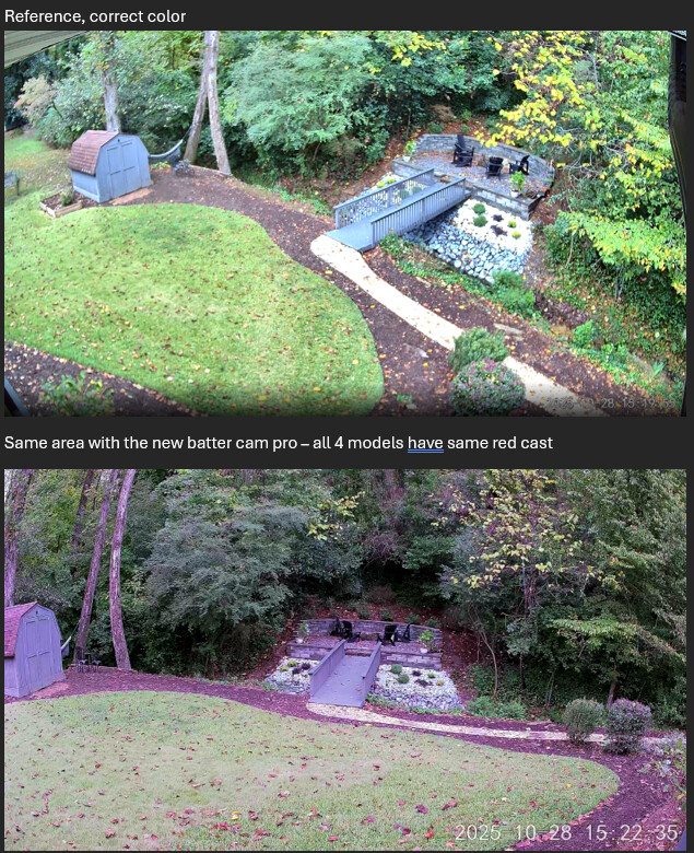

Multiple Battery Cam Pro cameras red tinted picture
I am on my 4th Battery Cam Pro. The first two displayed a reddish tint. I tried all the troubleshooting steps including changing settings, resetting the camera, renaming the camera (that seemed to work for a hot second), etc. I called support and got two more cameras sent to me.. same problem with both!!
Was this a bad firmware? Does anyone else have this problem?

Do you mind sharing a screen shot of what you are seeing as well as your night vision settings? Having four cameras with stuck IR filter is almost impossible. Something else is going on here :thinking:
Sure, not sure what the setting will tell you, I’ve toggled every one, tapped on camera, etc., and nothing fixes it.
“Back yard cam” is the reference. The other two are the issue. Support reviewed these pictures and agreed there was an issue and sent me two more.
From the posted pictures I see that you are comparing BCP to V4. See an issue with the Back Stairs Cam but not that much with the Back Yard Shed. It is a bit reddish but I think it has to do with the colour of the gravel on the pathway. You said that support sent you replacement cameras, do they perform the same?
Yes they all perform the same. There might be a bit of a difference due to the content/but when they are pointed at the same area, all 4 look exactly the same. Again, reset, tapped camera, did all the switching for IR/lights, etc., and worked for an hour with Wyze tech support. No changes or improvements. I am convinced this must be a manufacturer defect or software issue.

That’s not red, it’s purple. Do you have any strong magnet near the cameras?
