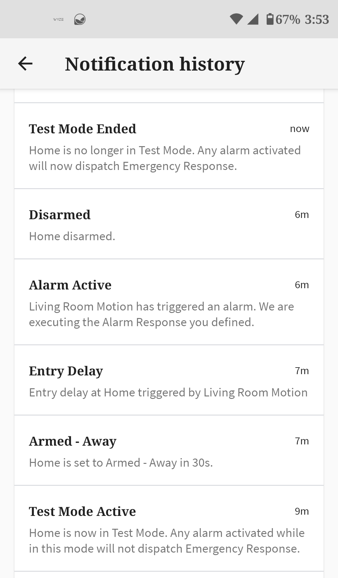

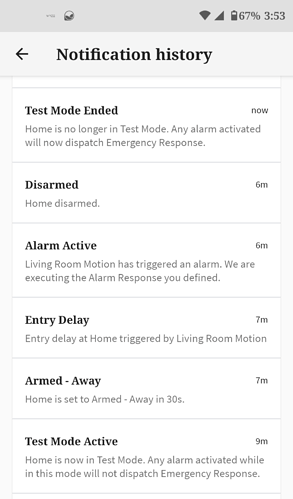

Every one of your motion sensors and contact sensors can be set to send an individual Push notification in each sensors settings.
Additionally, your HMS will also send out push notifications. For example, I just performed the following and received a Push Notification for each and every event:
  • Placed HMS in Test Mode
  • Armed System Away w\ Keypad
  • Triggered an alarm by movement on my Living Room Motion Sensor - 30 second entry delay
  • Alarm Activated after the 30s delay
  • Disarmed using keypad
  • Removed HMS from Test Mode
6 events, 6 push notifications
