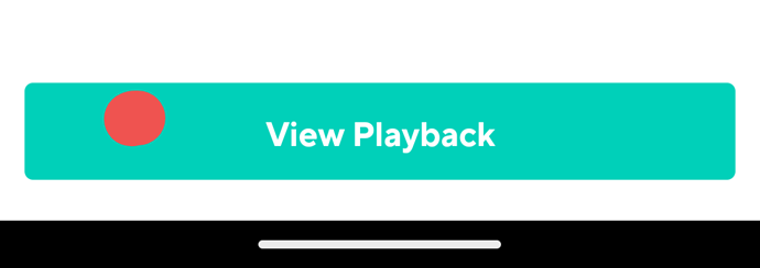

Not sure yet but keep in mind that local SD card events are seen by going to a particular camera and clicking View Playback. This is entirely separate from the Events tab, which represents "cloud* stored recordings (typically covering the same motion events).

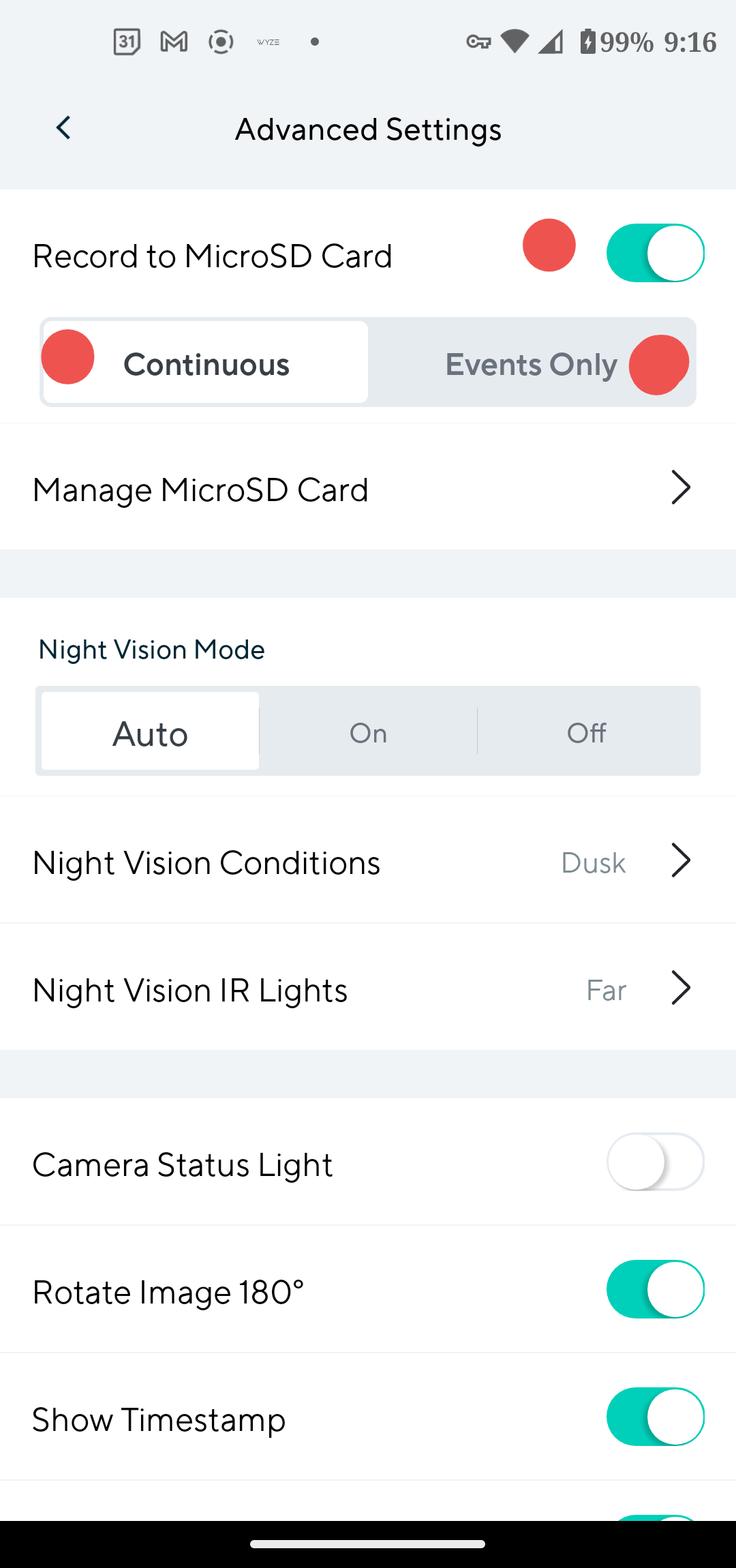

Local Recording to the SD card is controlled thru the Cam Settings :gear: Advance Settings. Since you want the cam to only save the recordings containing motion onto the SD Card, you would select Events Only.
The number of events you can fit onto the SD Card before the cam automatically overwrites the oldest video 1 minute at a time is dependant on:
  • GB size of the SD Card
  • Length of each motion event video
  • Recorded Video Quality (HD\SD)

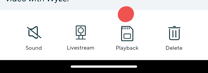

As @Customer already indicated, access to SD Recorded Video is only thru the app View Playback bar at the bottom of the cam Live Stream or the Playback Disk Icon at the bottom of an Event Video\Thumbnail in the Events Tab (cloud saved).

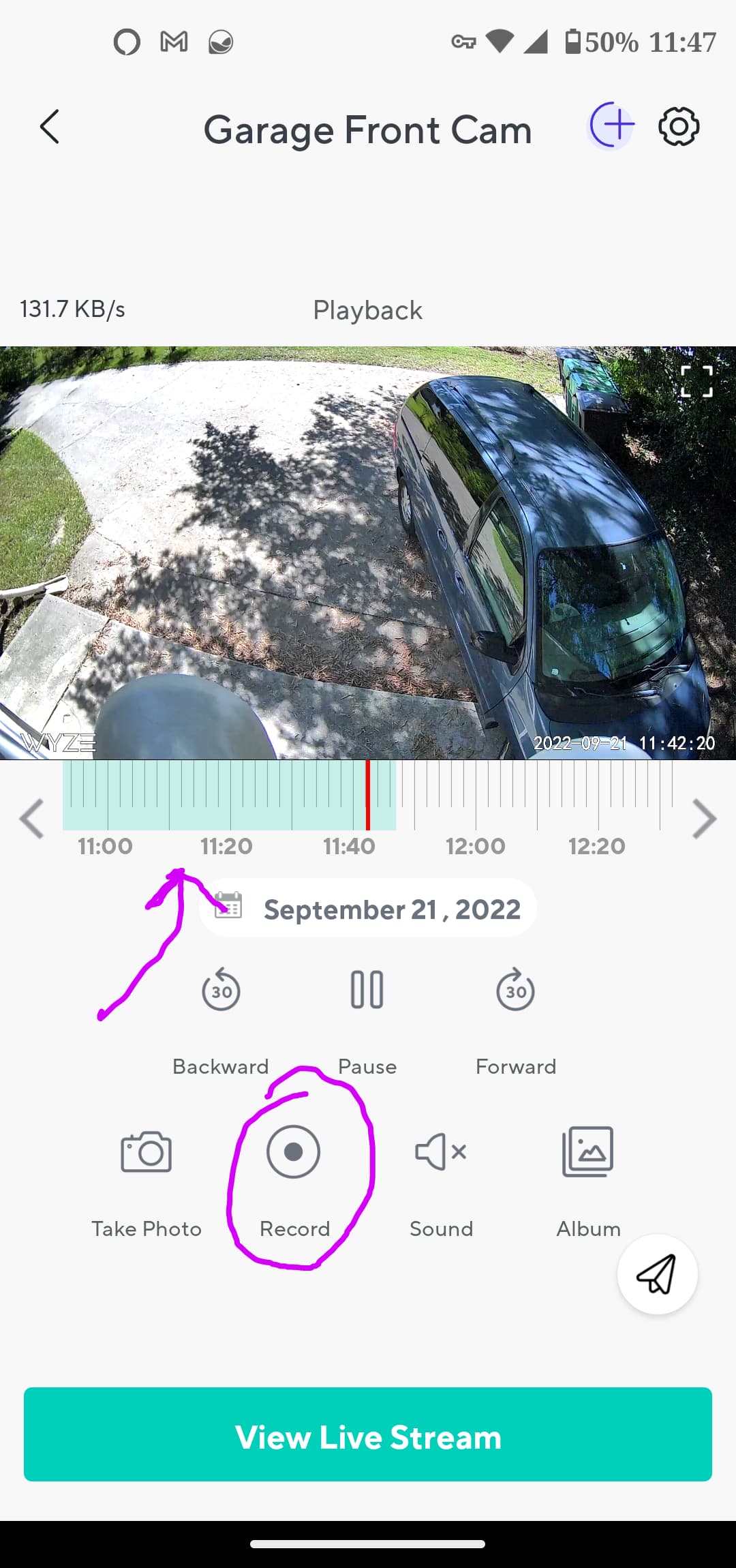

The record button you mention occurs in two places.
The first is in the Live Stream screen (screenshot). Pressing this will record a video clip of the live stream and save it to your device drive (phone, tablet etc.)
The second record button is located in the View Playback SD footage screen. This will record a short clip of what it is playing from the SD Card and again save it to the device drive.
The arrow indicates how to tell if your device is recording to the SD. If you have shaded areas in the timeline, or if you change the date to a previous date and see shaded areas, it is recording.

The ONLY settings for the SD Recording are in the Advanced Settings. You can only choose to toggle ON the SD recording and then choose Continuous Recording or Events Only.
The ONLY way to access the video that has been recorded to the SD card is to press the PLAYBACK bar in the Live Stream or the PLAYBACK SD CARD ICON when viewing a CLOUD Event Video:
These SD Card Recording Settings have absolutely no affect whatsoever on anything in the Events tab, the subscription status, or the Events Notifications.
