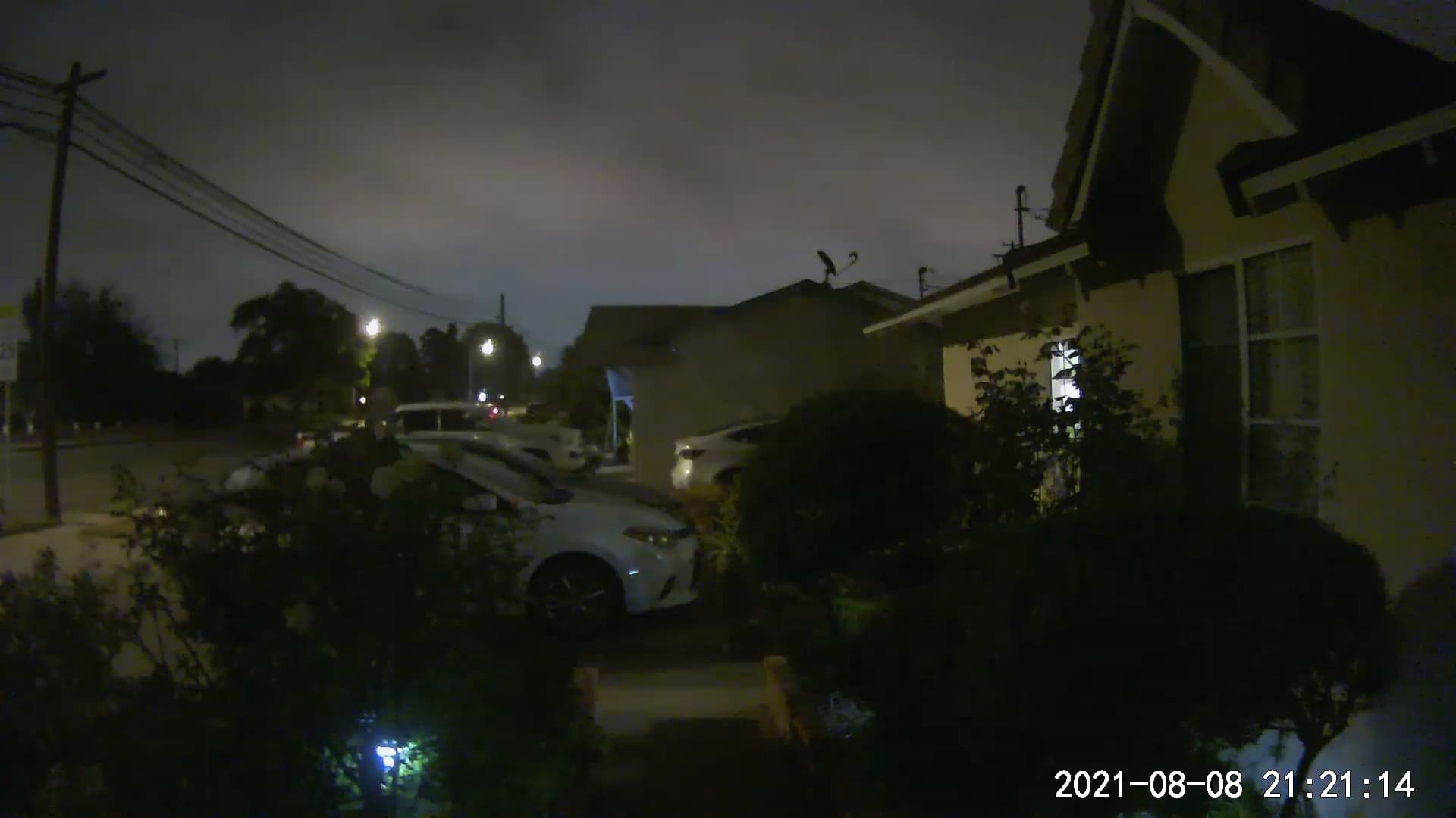

![c0d50a52-4310-413b-871a-1732bb6f120e.jpg|448x249](upload://jreRfOcOGmyeWRzvh6DhoUEZIet.jpeg)
Wow. That is great quality. There must be a problem with mine.

I happen to have a V2 and a V3 side by side. Take a look at the image quality.
The second image is from the V3. As you can see, it looks much better. Both cameras are behind a window and have IR off.
Why is the V2 even there? It’s because fireworks is visible from that Window. And the V3 can’t cope with the bright flashes.

The pics were taken a minute apart. The V2 time is off by an hour.

I just zoomed in to a car parked on my driveway and the plate is very legible.
But you mention a parking lot. It is a function of distance AND resolution. Zooming in at a greater distance (like a parking lot) would really reduce the effective resolution. The limitation isn’t the camera; all 1080p resolution cameras will function the same during the day, assuming the same field of view coverage.
One other factor to consider; the V3 has a wider field of view compared to the V2. Check my pics; it’s very apparent. So the same square inch of V2 image has an effectively higher resolution than a V3’s. Couple that with your greater distance requirement, and it explains why the V3 (in your case) is worse.
If you really want to read license plates, you need a camera with a higher resolution. Do you really think CalTrans uses 1080p cameras on the state freeways?
As to resolution, here’s a zoomed example of @Ipil60R34s’s shots, zoomed in on the house on the left. On the V2 you can barely tell it’s there. On the V3 you can count its windows.
