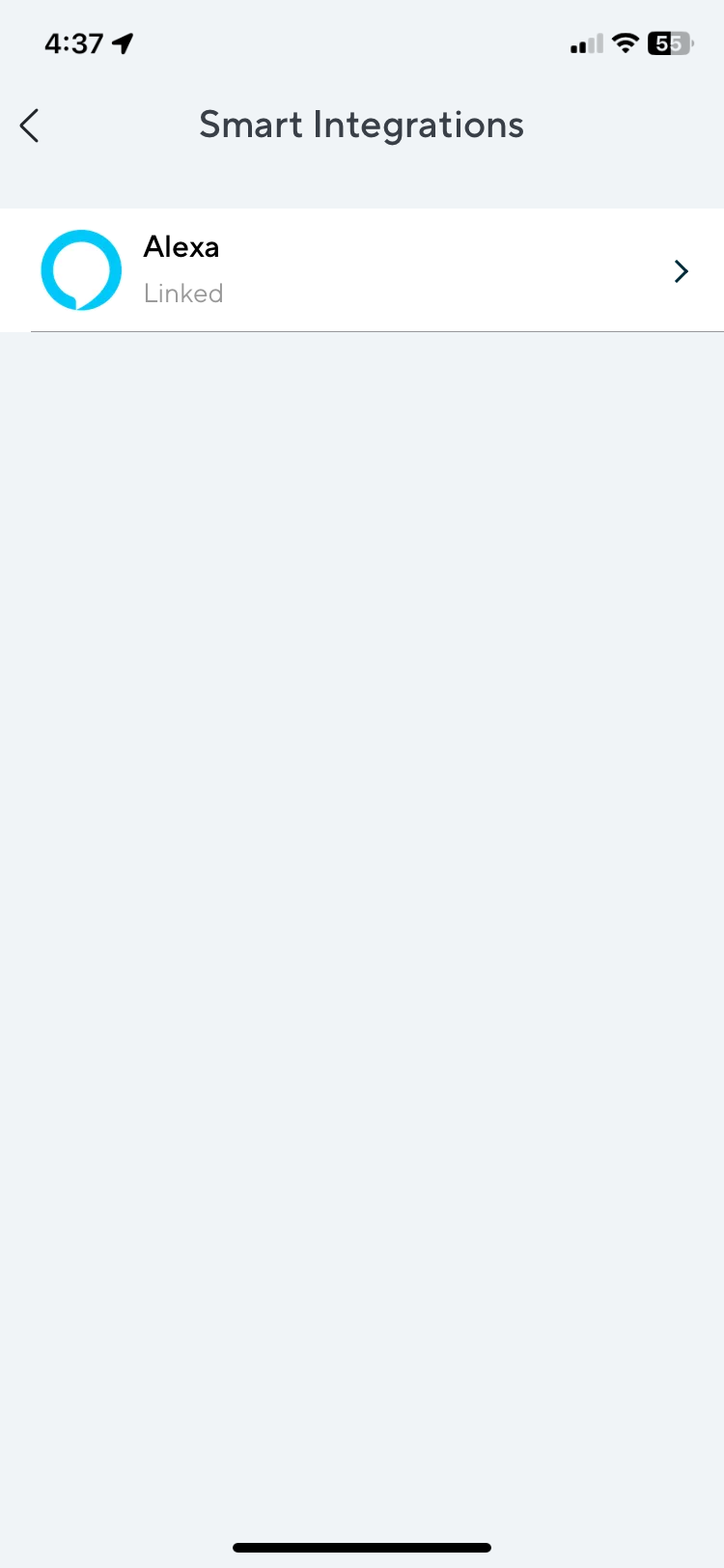

Go to Accounts tab and click on Smart Integrations :point_down:
In there you’ll find Alexa or Google or both if you have them and link them. All Wyze devices work with Alexa and Google. :point_down:
Then go into Alexa and create your skills and routines.
I’ve seen only Alexa as an option there. I think linking Wyze to Google Home has to be done within the Google Home app.
I don’t have Google so I assumed it would be the same as Alexa.
That’s not an unreasonable expectation. It’s just not the way Google does things, apparently. :man_shrugging:
I didn’t want @michael_winslow or anyone else to be confused by not seeing it there.

Yes, there is Alexa Integration. Once you do the instructions that were provided, Wyze Devices will show up in your Alexa App. Same for Google Home.
Alexa has much better automation and ability to trigger from Wyze events/devices than Google. It’s pretty cool.
I have it linked to google home… there are a whole bunch of issues there i’ve yet to delve into . but the wyze app doesnt know much about google in it’s automations as far as i can see…
for the most part i get the devices in google home. groups though im not sure of or havent played enough with. i have google linked and not alexa. in the wyze app automation there is no option to have an event signal google home - I dont have a nest device either - so i assume that there is nothing on the google side to talk to … my phone ? google home is there, but i dont think it’s used as an event handler. I’ll admit - i havent played much with that.
