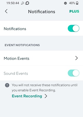

When I click Notifications the screens are slightly different from what you show

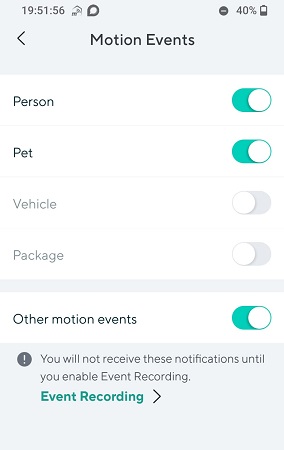

Expanding Motion Events, show me this
and I Can’t find an events tab filter. My Event Recording screen is also different from yours.

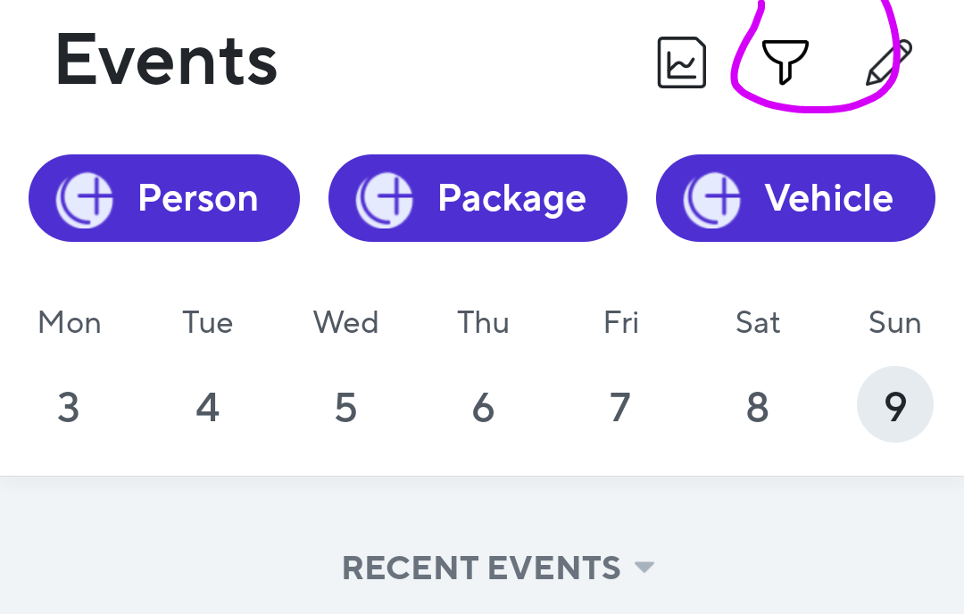

The “Event” tab, off the main page of the app. From the main screen of the app, at the bottom you see “Home, Events, Monitoring, Shop, Account”. When @SlabSlayer has been referring to the “events tab”, this “EVENT” tab is what he is referring to. This is where your cloud event clips are shown. Within the event tab, you have “filter” options to only display AI videos.

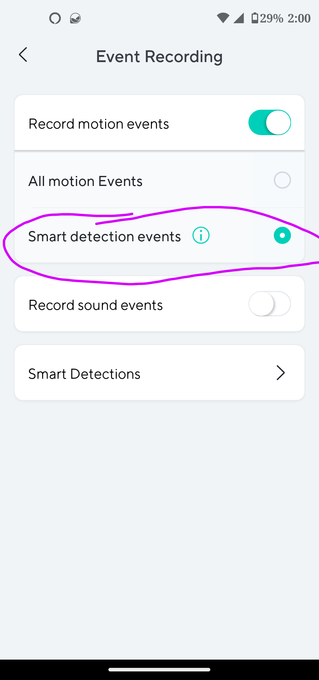

All your screen shots are taking from within the camera settings menus.

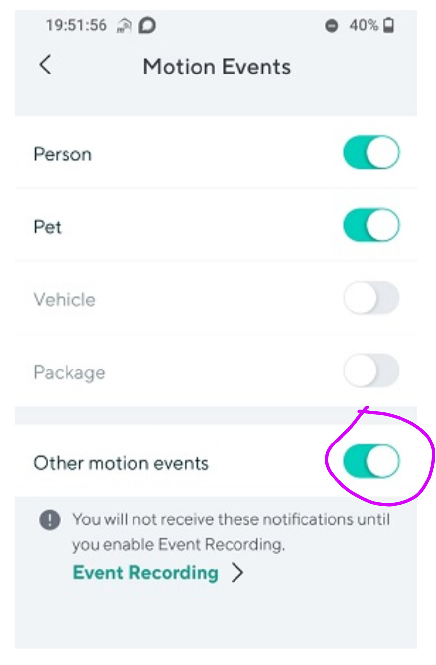

In your Notification Settings, when you click Motion Events, this is why you are receiving notifications for Motion Events that have not been tagged with any AI tag:
My screenshots were for the V3 cam you referenced. Your screenshots are from an OG. The OG does not have the ability to limit the uploads save to only the AI Smart Detection tagged Events. In the case of the OG, the only option is to set the Notification settings as I suggested and filter out the motion events in the Events tab.
To do this, click the funnel icon in the he top right of the Events page and scroll to the bottom.
I used this feature just to select which cameras or group of cameras I wanted to see the events. I never fully scrolled and now I just discovered something new. Thank you very much!
