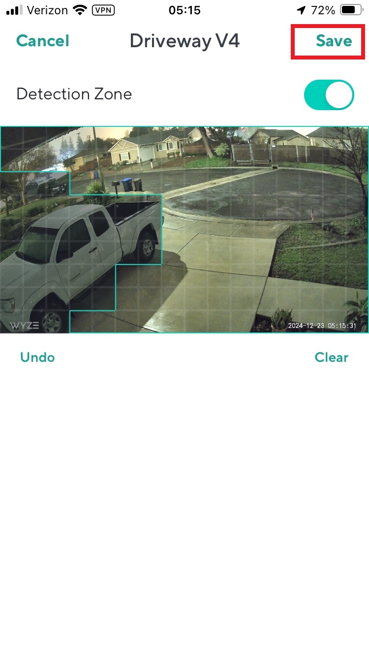

All my other camera detection zones are like this. To test, I inverted the detection zone and still got notifications of movement outside the detection zone.
All your cameras are backwards then ![]()
Greyed out = ignore/exclude this block. Normal image = detect in this block.
You sure you don’t have sound detections on or something else that could be causing the detection? While sometimes things close to the edge of the detection zone can cause false triggers, if you’ve inverted that detection zone now, the car should definitely not be triggering motion detections.
Here is a clip showing everything is greyed out. Then I select the detection zone, which changes from greyed out to clear. Then I select ‘clear’ which changes everything back to grey meaning nothing will be detected.
With this detection zone, traffic outside the detection zone is detected.
When the detection zone is cleared, or when the detection zone is disabled, it means any motion on the frame is detected, iow, the whole frame is the detection zone.
You have to set your detection zone and then save it before it takes effect. As @p2788deal says, if you clear the zone or disable it, it is no longer active and everything will be detected.
