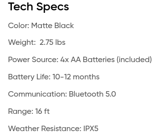

Perhaps because it isn’t a network device, only bluetooth:
Do you own the Wyze Lock or Wyze Lock Bolt?
If you have the Wyze Lock Bolt, as WildBill indicated above, it is Bluetooth-only.
