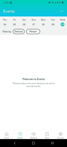

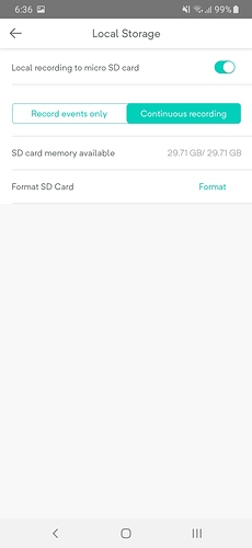

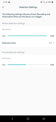

Brand new Wyze camera user here as well. Followed the setup guide. I can view the live feed without issue. I can also manually record clips, but I’m not getting any events being recorded. I’m dead sure that I have it configured properly. It’s also failing to record to the 32 GB micro SD card, despite it being formatted correctly, and recognized by the camera. The available space doesn’t change on the card, and I don’t get any events recorded. It’s using the latest version of the Android app and the latest firmware (4.9.4.169).
If I can’t get this working, I’ll be returning it. I’m beginning to think I’ve made a mistake by not going with a competitor’s product.
The SD card video is viewed by tapping ā€œView Playbackā€ from the live stream (not in the Events tab).
For the motion/sound/person events not being recorded, please post screenshots of the relevant settings pages in the app.

Here’s screenshots of the various screens. There’s definitely been activity that shows motion in front of the camera, but no events recorded, and nothing is being recorded to the micro SD card, despite being set to continuous recording.
Your settings all look good to me. Have you submitted a Support Request ? Could be a bad camera that needs to be replaced. Also, have you run through the troubleshooting steps found on the Support Site ?
I haven’t created a support request yet. I figured I’d seach online first, and the original poster had the exact same sounding issue. I’m going to try hard resetting the camera, as well as try the other camera I got, but not update the firmware on it.
