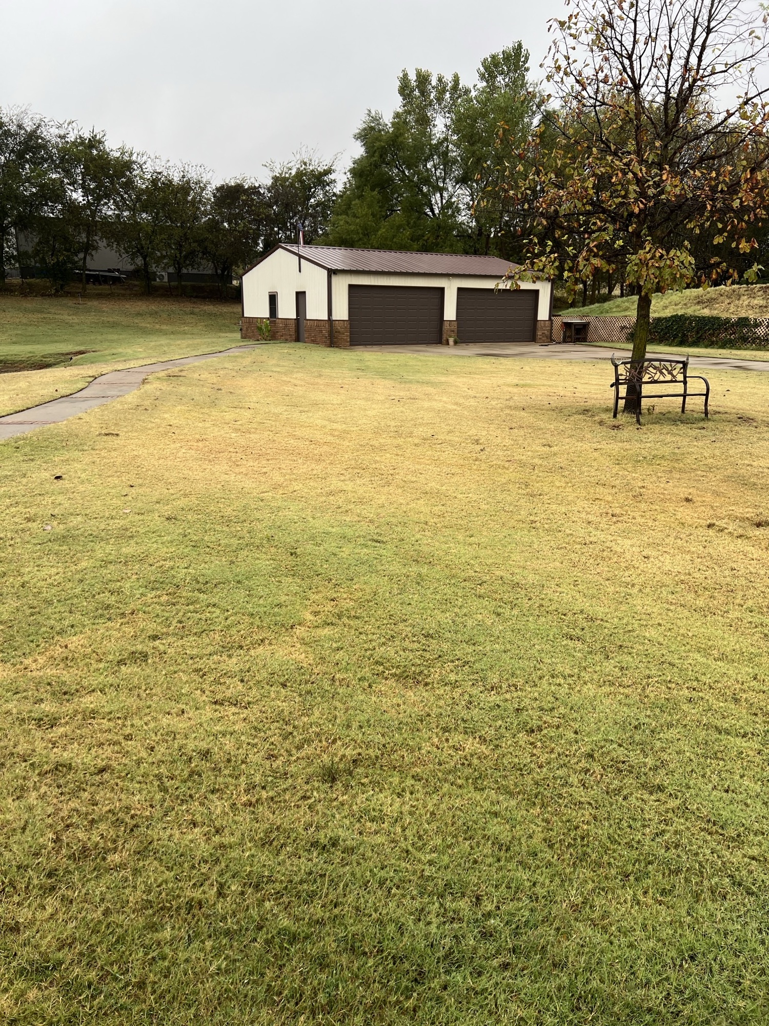

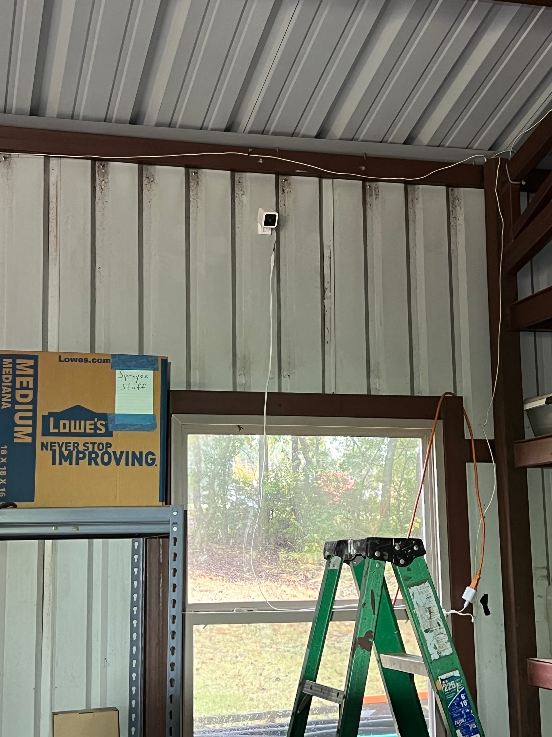

I have a “shop” which is 30 feet by 40 feet and normal height. It’s made from all metal – steel frame and metal roof and wall panels. It’s got two double-wide garage doors and four windows. I have a V4 camera mounted on the outside of the front wall pointing away from the building and a V4 camera mounted on the outside of the rear wall pointing away from the building. Both cameras work fine.
I have a V3 camera and a V4 camera inside my metal building. The cameras usually show that they are both offline, although one occasionally shows online. But not often. When they show offline, they still detect motion and record, but they don’t notify me. I have moved both cameras to many, many different locations inside the shop, trying to get them to work properly. And I have switched cables and power supplies and electrical outlets. I can open one of the garage doors and set one of the cameras just outside the opened door and it works OK. Bring it inside and I have the same issues. This has been going on for a very long time.
My wifi was extended from my house to my shop, which is about 80 feet from my house with my router being on the other end of the house. Someone did this for me and I don’t know what they used. I know they put some sort of receiver inside my metal building to support my cameras. The two cameras mounted outside work fine. Inside – not so much.
I don’t believe it’s a camera problem. It looks like the problem is caused by the cameras being inside a metal building. Has anyone seen this camera behavior before?

Thanks for the reply. Yes there is something in the attic of my house (closest point to the shop) that I’m guessing is pointed at the shop and something in the shop (at the closest point to the house) that I’m guessing is pointed at the house. I will take a picture of what was put in the shop tomorrow and post it. I haven’t checked to see if my phone switches to cellular. I’ll also check it tomorrow. But please keep in mind that all 4 cameras work off that remote receiver inside the shop and the 2 outside ones always stay connected. But not the 2 inside ones.

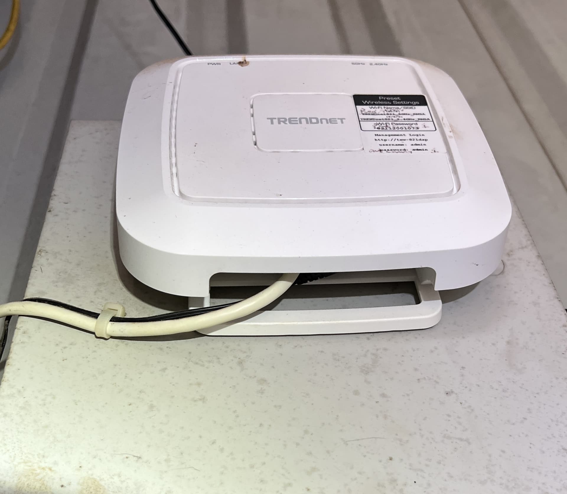

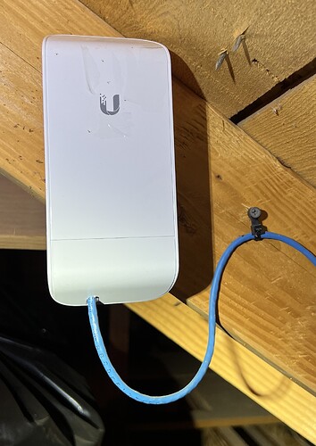

My router is provided by my internet provider. It works well inside the house and is on the north end of my house and the garage is on the south end. The shop is about 100 feet south of the garage. There is a cable going from my router up into the attic and over the garage. It is connected to a device with a U on it. In the shop, there are a couple of devices that I assume are the things the U device talks to. One is a Trendnet device. I can’t tell what the other one is. This setup was done several years ago and I have had the problem for at least the last year or two, maybe longer. And by the way, both cameras just recorded me walking around in the shop testing the wifi signal while both cameras are showing as Offline (in red) on my list of devices in the app.

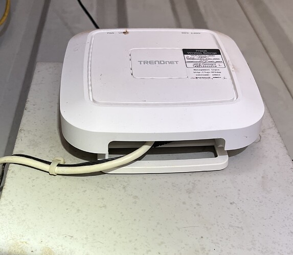

Did you change the TrendNet access so it is no longer “admin admin”?
I don’t know enough to change to/from anything. It’s set to whatever the guy set it to when he set it up years ago. I have changed my internet password, but that’s all.
Here are TrendNet instructions if you feel comfortable getting into the configuration settings.
The installer changed the credentials and wrote them on the case. I zapped them out.

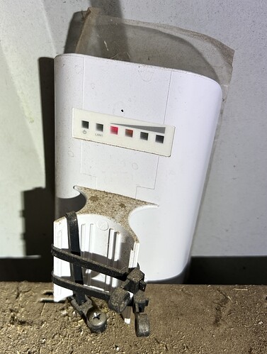

The two “U” devices are a Ubiquiti point to point wireless link, which is good. The issue is the remote one (second U in your 3rd picture) in the shop is sitting behind a metal wall and not mounted outside or even up high. I’m not sure if it fell off something or what, but that’s definitely not where it should be. It needs to be where it can get pretty clear line of sight to the first U device in your attic.
Those U devices are directional, not super focused but the faces need to be pointing at each other without metal in between them. They can work through a window or wood (not ideal but should be fine) but only if you can get them pointed at each other through those things. It looks like that would be hard to do unless the window next to the regular door in the shop has a view to where the first device is in your attic.
That’s going to be your issue, when devices in the garage are connected to the Trendnet access point, they think they have a very strong signal, but in reality that trendnet has a very poor connection back to the house, maybe enough to operate a smart plug, but probably not enough for a video stream or anything like that.
If you can get that device somewhere that it has a better signal back to the house (has a signal meter right on the back) then you’ll probably eliminate all your issues in the shop.
To put it another way, think of those two U devices as a virtual cable between the trendnet shop wifi and your ISP router. Right now that cable has been cut almost completely in the middle, but luckily fixing it is relatively easy.

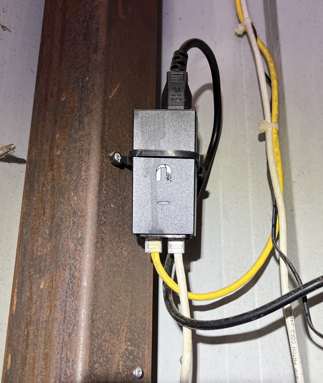

The U device in the shop did not fall, it was screwed in place. Here’s what I see. Another small U device is plugged into an outlet. It has 2 (ethernet?) ports on it. A yellow ethernet wire goes between the U device that should be outside and this small U device. And a white ethernet wire goes between the Trendnet device and this small U device. These devices are just inside the shop, on the left side of the garage door. I could fairly easily disconnect the U device that should be outside and mount it on the outside wall just left of the garage door, and run the 2 wires (ethernet and power) thru the metal wall and connect them to where they are plugged in right now.

Yes, but it looks like the login to configuration management is still “admin admin”.
Maybe not a huge deal but I always change the credentials to access settings of my network equipment.
