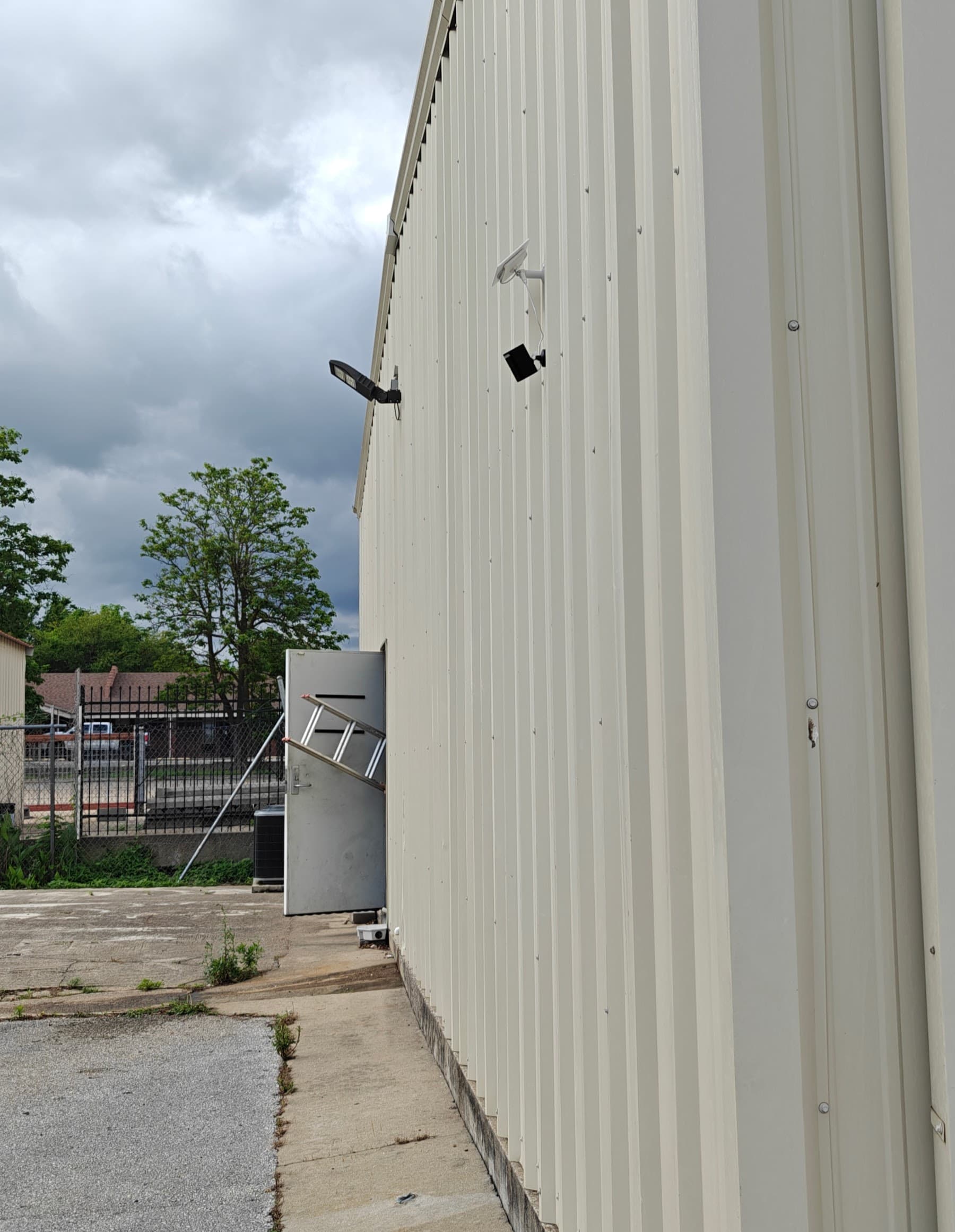

The whole idea was to be able to have a camera continuously record that we can’t run power to, on the exterior of our business’ building. Here is what it looks like (wall is west facing):
Yes, I realize it was cloudy on the particular day that I took this picture. But TODAY, for instance, there was a solid 6+ hours of full sun after noon and the battery died at some point after 2pm. This is after troubleshooting and trying a 2nd battery AND solar panel while having issues with it not charging over the past week (I bought 2 sets of this camera & panel over the last Black Friday sale).

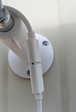

I had considered the fact that maybe the USB wasn’t plugged into the camera and/or solar panel all the way, but I MADE SURE it was plugged in all the way when I switched out to the 2nd solar panel. And I mean, I AM still a little concerned because this is what the camera-to-panel plug looks like when I slide the sleeve out of the way:
I pushed them into each other as much as I could and it does NOT go in any more than that.

Just throwing this out, optimal panel installation should be facing due south and between 40-45 degrees. There a online based calculators that will give you all that info based on a your geo location.
