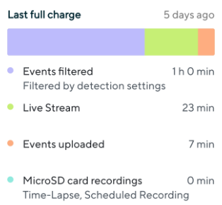

This is the battery usage:
How do I interpret this? Are there events triggering a capture that donāt get sent? I donāt have any events in the app, certainly not an hour worth.
23 minutes of live stream? I have not watched the camera live for that long since the last full charge.

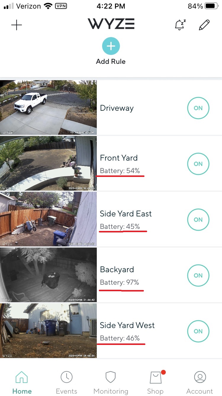

I have no idea why some members have excessive battery use. I have 4 WCO installed in October 2020 and never had a battery drain issue. I have all 4 cams on scheduled event recording to the SD cards in the cams set for 10 days at a time, no cooldown period and a max.video length for each event set at 2 min.
Below are my cams today. The front was last charged 9-12-21 and records many events, East yard charged 9-3-21 and records many events, Backyard last charged 9-12-21, few events, West 9-24-21 many, many daily people, cat, possum and Raccoon long video events. My cam firmware is 4.17.1.287, base connected via ethernet, 4.16.2.26. All cams have a great strong Wi-Fi signal to them. And now I probably just jinxed myself ![]()
