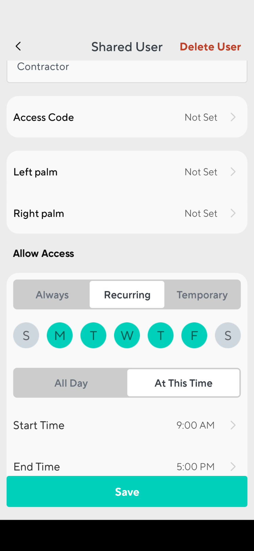

On the Palm Lock, you can setup a Guest Code or Access Code to allow a contractor to gain access to your house.
This is done by setting it up as temporary Access with a start date and time and and end date and time. So basically, you can say the following:
Access Code 1111 (for example)
Start Date of 10/7 at 6am
Endate of 10/11 at 6pm.
But this will allow access to using the code during that period of time only.
-OR-
you can setup a recurring
setup which days of the week, and then provided a start and end time. that will limit access only during the given date and only for the start and end time period.
Boom.
