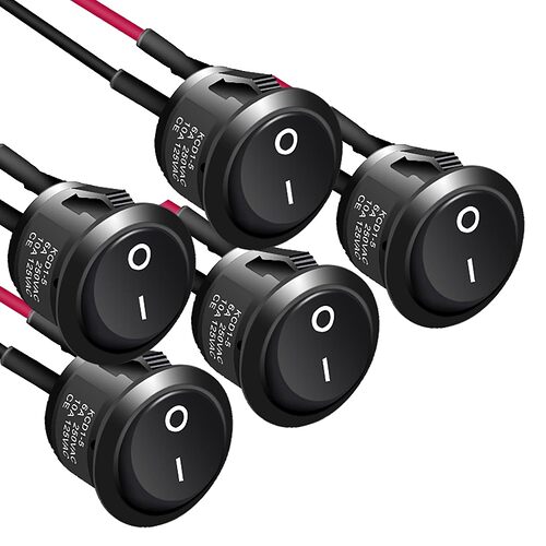

I’m having the same issue it seems. worked fine all day on the install … then constantly showing offline with the orange blinking circle. Not super easy for me to simply power cycle it… the doorbell is on the same breaker as two rooms that are actively being used most the day.
Last I checked it had two bars of wifi strength which seems like that should be strong enough.
I installed this rocker switch so I could disrupt power to the doorbell only.
Before the Wyze doorbell, I had a Wyze V3 camera in the same location. I do not believe it is a WiFi strength issue. I think the Wifi connection may time out, requiring a reset because after I cycle power on the doorbell, it immediately connects back to the wifi.
thats a good idea, but wish they would add a power cycle pin hole somewhere (hidden) on it.
