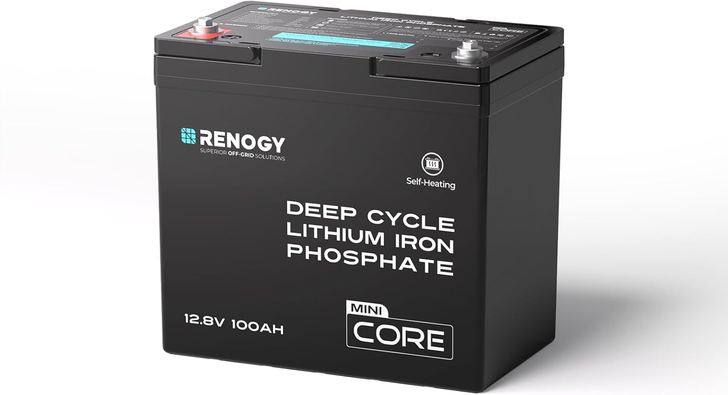

Renogy mini cores series batteries are high in quality and are the closest you will find in build quality to a Battleborn LiFePO4 battery. Battle born is the quality leader of those batteries in the U.S.
The Renogy batteries are much more affordable :grin:
So after much review I went with Renogy batteries in several battery backed power systems for my needs
For outdoor use where it freezes I used a self-heating version of the battery.
Waited for it to be on sale though at $239
