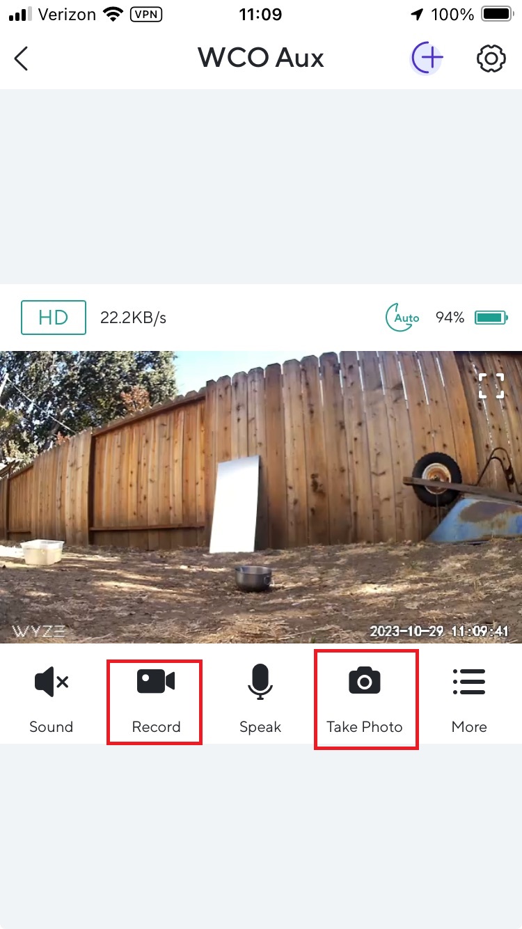

If i manually record a video, I can view that via the App.

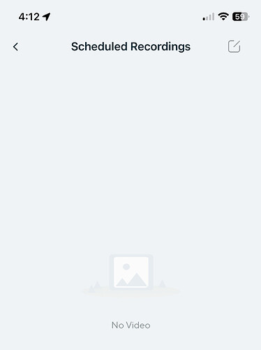

If I schedule to record for a month using motion detection it should record videos and store them in the card. I should be able to view them (12sec max) under the archive tab (top right). It used to work sketchily to say the least. I recently tried Cam Plus which allowed longer videos with no break between them. This also performed poorly. Videos longer but not much. Poor motion detection. I even tested it walking in front of the camera. Sometimes it worked sometimes it didn’t. I cancelled Cam Plus and will never buy a camera from Wyze again. And I have a number of their other products. The base camera with no plan should work. Your suggestion looks like it will only work with one of the plans. If so, then Wyze is engaging in blatant false advertising. Why seek a camera that does nothing?! I only found out about Cam Plus after purchasing the camera. I don’t remember any mention of the cameras limitations out of the box. I have two large SD cards in both the camera and base station which apparently do zero. I even have a new screen shot, in the video box, at the bottom of the archive. It was taken 15 min ago which I was in. So it obviously sees the movement. But records nothing. The camera is buggy to say the least. Completely unreliable in terms of security. The answers being given here are inaccurate. The camera should work out of the box. Motion detection and video recording. It did when I got it but it was always very inconsistent. These people have the same problem I have. No solutions have been offered. I have spent hours with support. Nothing resolved the issue.
Sorry it’s under Album, not archive.
Attached screenshot indicating video taken.
Then when you click on the video and there’s nothing.

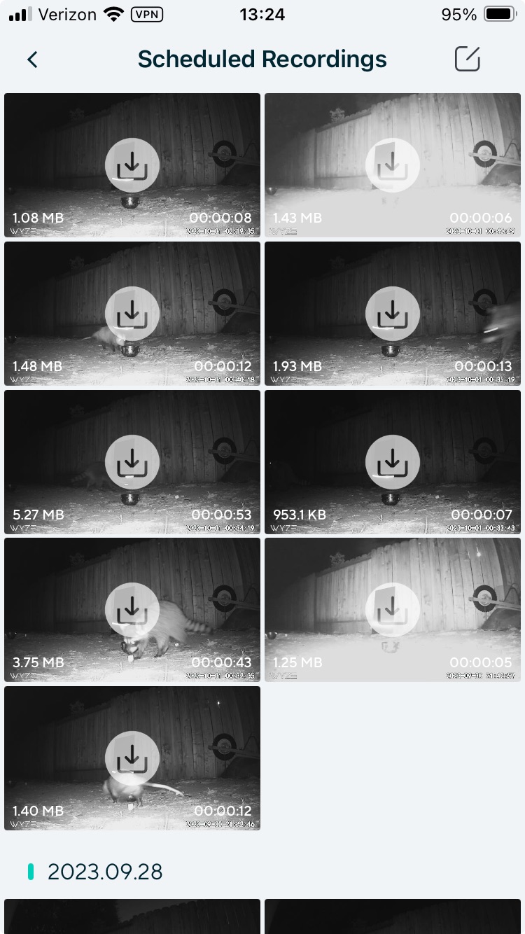

I have no idea how you set up scheduled recording but when I use it I can view all the events in the album. I had to limit the length of the videos to 2 minutes during scheduled recording because of to much use and some of the videos were over 10 MB. This is the last time I used scheduled recording (First screen capture)
I put the camera on Cam Plus 2 weeks ago and they work.

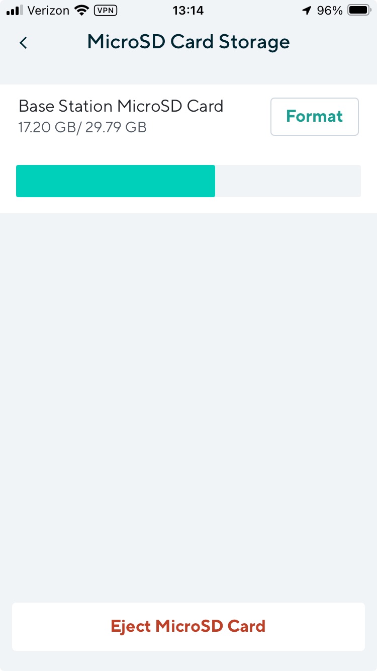

Backup to the base also works if you have Cam Plus Lite or No Cam Plus. It will not work with Cam plus. Note: You have to click save every time you make a setting on the scheduled recording settings like duration, events only, and how many days or hours, no cooldown period and so on.
What scheduled recording settings have you been using? Setting those is the only way you will get a recording that shows up under the album.
From your post it sounds like you are speaking about local SD card storage and cloud storage at the same time, but these should be talked about separately as they are different functions and operate independently of eachother. They each have a different set of settings in the app.
Can you provide a bunch a screen shots of your different settings pages and the views that your cameras have and I bet fresh eyes on them will be able to suggest assistance.

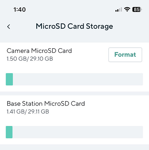

I have 1.5 GBs showing on the cards but nothing shows in the app. If I take a picture or record a video it saves them. They’re all deleted. The real time feed is working. It simply
Won’t show anything. The scheduled video could be working but since it won’t show them I can’t tell.

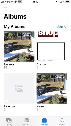

If you take a picture or record a video they are saved in your iOS device photo/Media album.
Scheduled recording is: open the cam to live view, tap more, tap album. That album has the contents of the SD card.
Just took a picture
The album in the app is empty. I delete them off my phone. The card shows 1.5 GB but the App shows nothing. Whether they go to my phone is irrelevant. When I delete them off the album on my phone it should have no affect on what’s saved on the cards. I will eventually pull the cards and check them on my computer. I’m disillusioned enough to lack motivation at this point. They’re on the card but the app won’t show them. No reason.
