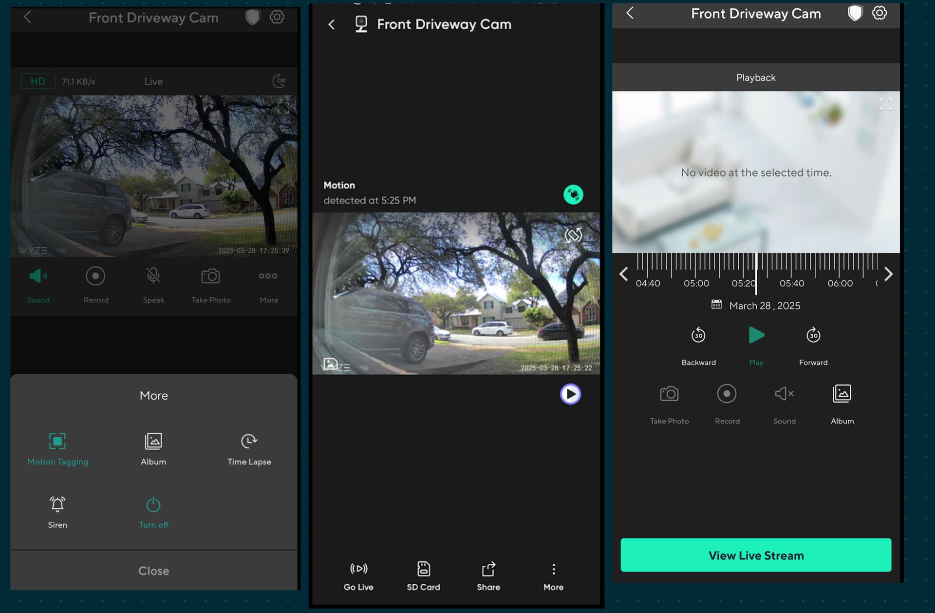

I just logged in here to ask about this very topic. I have an SD Card in my v3 with 4.36.13.0416 firmware that used to work but within the last few months to a year I think, I have not been able to see videos tied to events any longer. I know that I can manually record video to the card, so I think I have it set up correctly. I have event recording on for all motion events, and I’m pretty sure that I know the UI flow to get to the event videos, but the app constantly says that there are no videos to view any more. This first camera was something I was kind of testing out, but now want to start using it and others more. Any ideas as to what I and perhaps the OP are doing wrong?

I had been on continuous for the last few weeks and just switched back to events only today after my first post, and neither show events on the timeline. Is continuous the setting that you use? I used to not have to do that, so perhaps I’m looking in the wrong place for the videos tied to events?

I don’t have v3s, they use a slightly different interface, but if you just go to the cam live view and tap the SD card button, you should be able to navigate around in there. Anywhere there is a recording, the timeline should show green, and if you have events, I believe it will have an icon for those too (all my cams do, but like I said the v3 is an older interface so not sure if it has those).

Note there have been some issues lately (Panv3, but I think the v3 may have also had some) where trying to view event video from the events tab, then going to SD card from there would cause some messages like no video available. So try going through the cam live view and into the SD card, see if you can get to the recordings that way. If so you may just be seeing one of the bugs with the event screen.
The V3 camera uses the older UI so it’s the big green bar at the bottom of the camera display that says “View Playback” - not the SD card button.
Perhaps the problem is that I’m using the latest Android UI with a v3 camera?
@dave27 I did not see a way to navigate to the SD card from the live view…only from the Events view.
(edit @K6CCC I actually re-read what you mentioned. Clicking View Playback does take me to the same screen with no videos playback available)

Also just verified that I can manually save photos and edits to my sd card from the app but neither events nor continuous recordings save.
