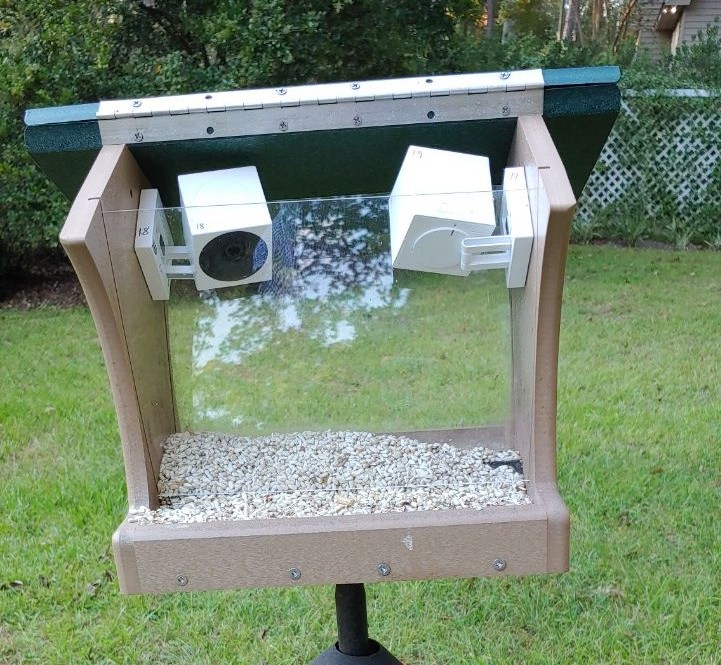

Last week, I was visiting the parents and had in the back of my mind to install a spare WCO v1 inside their medium-sized bird feeder. The idea of course being to get customer close-ups… :smile: After (3) attempts, I finally got the positioning & aspect where I wanted it… and all dining birds well within the PIR effective area. Since a single cam only covers one side of the feeder, I decided to get a second cam (WCO v2 from the local Home Depot) in order to cover both sides. Positioned the new one similarly to the first but on the opposite side.

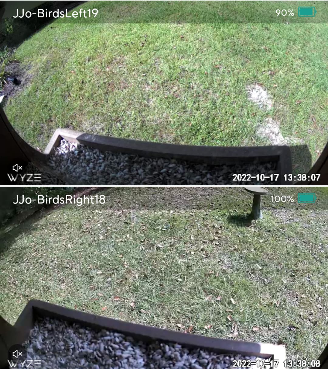

Here’s a side-by-side that gives a good idea of positioning relative to blue PIR zone below it.
The weird thing is that I don’t ever get any motion-based capture events. Trying to determine if the plexiglass behind which both cams are mounted somehow blocks infrared to the point that no motion registers. Depending on the time of day, there is definitely reflective feedback from each opposite side of the feeder, but most of the time the field of view is clear. Weirder still, I seem to get smart alert captures periodically when birds arrive or depart, but those are few & far between. The only time I ever seem to get motion-based captures are when the units actually power on for each daily cycle. I’ve created no rules attached to sensors or anything else that would explain smart alerts to my knowledge… :man_shrugging:t2:
I have dialed the proximity setting (detection distance) down to (2) since the birds are very close up obviously. Also set the motion sensitivity to (73). I have tried various settings including proximity at (1) and motion at (99) or (100), but results are the same. I’ve also experimented with changing the cool down periods alternating between 1min & 3min. There are definitely several timespans per day when birds are prevalent, but also long swaths when no birds appear.

In general, I believe that PIR sensors have issues detecting through glass, and probably plexiglass as well.
Can you easily trigger motion events moving your hands in front of the feeder?
What happens if you just use a small amount of seed and remove the plexiglass?

I’m no longer on site, but don’t really want to modify the bird feeder operation itself since the cameras are more of a “nice to have” and not mandatory. An alternative idea I had is to use a circle saw bit to place a few holes in the plexiglass above typical seed levels, within the PIR zone, and at bird level. I’m thinking that that will actually end up capturing what I’m after, but still in the deliberation stage.

First I would try increasing the detection distance, have you tried it at 100 to see if you ever get events for the birds. When you get a chance I think it would help to cut holes in the plexiglass as well.
The angle is more Paramount if you’re attempting to use the AI features. For instance in the past it was noted that person detection could be less accurate if the camera was angled or if the person had approached and an awkward angle. This is something that has very slowly been improved upon with AI updates submitted by the community. But it is still being worked on and refined more.
More than likely your biggest detriment is indeed the plexiglass. I had tried to use the outdoor cameras for similar things and the only time I’ve gotten consistent recordings is when there’s no barrier at all. I actually ended up changing a location so that a feeder was hanging off of a tree and I could Mount the camera to the tree. After doing that having no barrier in between I got plenty of recordings even on tiny birds. I can even get recordings on hummingbirds as long as there’s no barrier. And fortunately for comparison I have a thermal imaging camera that uses passive infrared, although it is far far more sensitive than our cameras, it’s amazing to see how much you don’t pick up by even a thin barrier. Direct contact or direct line of sight is the only way that PIR is truly effective.
As an alternative next time you’re back there, you can take us very small thin board and screw it to the bottom so that it extends five to six inches out on either side and just place the camera on that. That will give you a good view of how the birds would be able to sit and they would probably even be closer to the camera as well giving you some cool angles :slight_smile:

It was an expensive Christmas gift last year, so I actually don’t really want to modify the stock panels. If I go to this route, I’ll probably purchase new plexiglass, cut it to fit, and season to taste with circle saw holes.
Thanks for the suggestions, @Bam.
We actually noticed last year when we replaced the previous bird feeder with this one that no birds trusted it for roughly 2 weeks after installation. There is concern that any appearance modifications might cause a similar hiatus. Preferable to keep them internally mounted and see if I can improve event capture in this case.
We are planning on some sort of bluebird house down the road and I will factor in an external mount for this at inception.

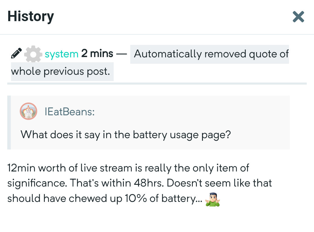

SIDE NOTE: I have had the issue below several times here in the forums where I choose to quote the entire post and the system removes that from my message. I then go back and add it manually a second time and it sticks. Is that a glitch or by design?
