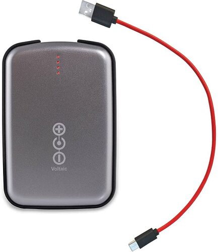

How’s your setup? Is it the power bank with the solar panel on it or is it a panel that is just charging the power bank that is powering the cam? Have you see the power banks by Voltaic systems, I believe they may have what works.

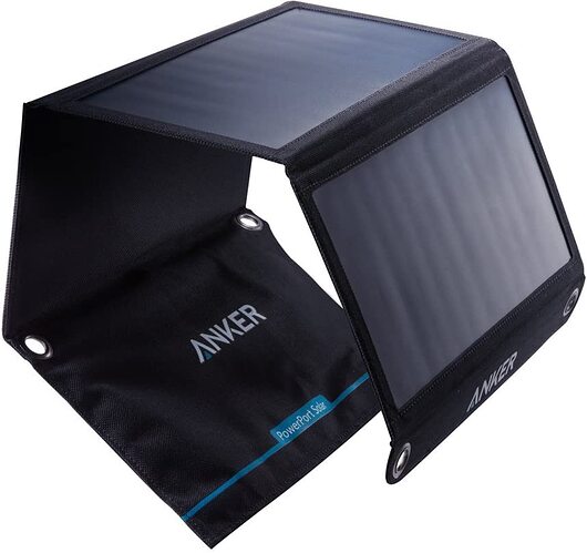

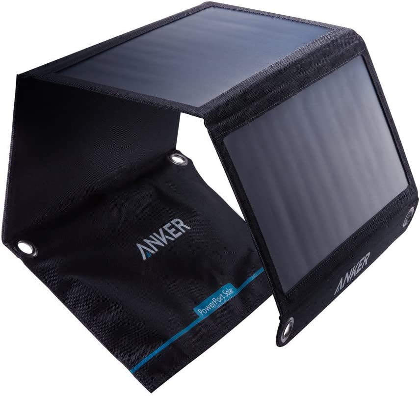

I have a 21 watt solar panel charging the battery bank. The 2 power banks I’ve tried will power the camera while they charge. Everything works fine until when the sun comes up and the battery starts charging. If I plug the battery banks into an a/c outlet then it runs continuously without any problems so it has something to do with the solar panel starting to charge the battery.

I’m using this panel. Not sure how to find what you’re talking about.

Take a look at voltaic battery banks. The support pass through charging and should work. They are expensive but they are the only one that I see supports pass through charging. They also have a 19000 mah.

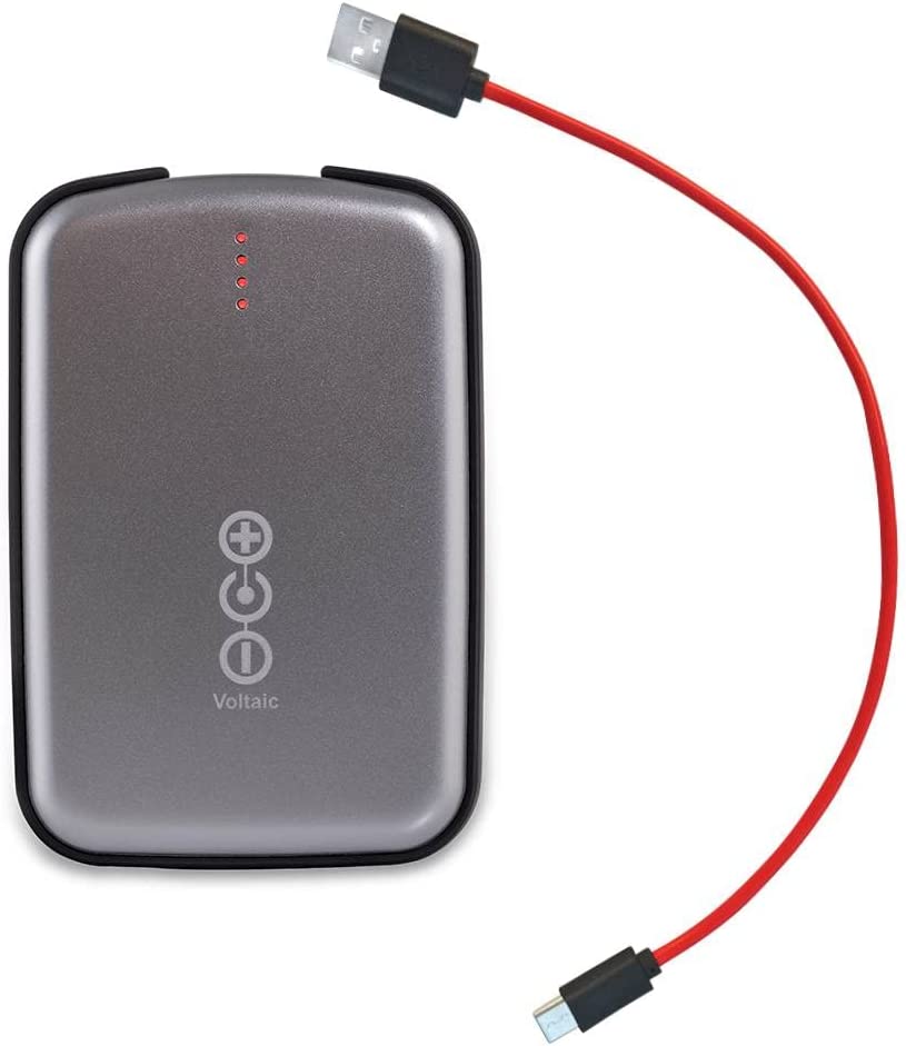

Thanks SuperStorm! I wanted to make sure their product worked be for spending too much so I bought the V25 6400mah and it works perfectly. Camera stays powered on streaming 24/7 now. I may need the stronger one in the winter or if we have bad weather and a few days without sunlight but I’ll wait and see. Right now if works perfect for what I need.
I’m using the
with this solar panel.
