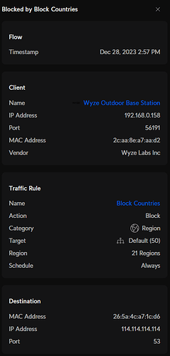

Early this morning I was reconnecting my outdoor base station and cameras which all needed firmware updates. I had the previous day also did some firmware updates. These cameras had been offline since I had a concern of a breach at my home. My router blocked activities coming specifically from my Wyze Outdoor Base Station, twice. Does anyone know if Wyze uses a specific China IP address for firmware updates or similar. See below my notice. My Base Station Mac Address attempted twice to connect with 114.114.114.114.

Yeah, totally email them, and let us know what they have to say. That IP is a mobile communication company in China, so im very, very doubtful its an IP for anything Wyze (even with that info tech inc. title). Remember China is the two states one system country, so every company operating in that country is beholden to the China Authorities, which absolutely includes spying, and/or obtaining any data a company has.

Id also recommend going into your router and enabling geo-blocking by country, and including China (and any others you want) in the block. Of course they can have a VPN or server in another country, but block the obvious first. Glad your router/firewall spotted that.

Its a DNS server in China. That needs to be taken out of the base station’s code.
here, this tells of that IP address: https://www.reddit.com/r/EufyCam/comments/hdyyy4/do_you_trust_eufys_security/
Why would it have a Chinese DNS server IP address, hardcoded - has to be as it would get DNS from the routers DHCP - in the base stations programming??? we have plenty of DNS servers in the US (and around the world), plus the one our ISP assigned our internet modems.

I also just started to get the same notification on my router from my Wyze hub. It just started two days ago and I have not updated the firmware recently. 4.16.2.66 is my current firmware. I submited a log but I will also send the information to Wyze security.

Wyze Cybersecurity responded to me that they duplicated the issue and alerted thier firmware team internally. The behavoir is to be fixed in the next firmware update. They referenced that “The DNS Queries will be limited to US servers only.” I appreciate their quick response, however, I am now concerned that no one in their US team is reviewing the firmware code. I was comfortable with Wyze because they were founded in the US from Amazon employees. I assumed even though they sourced out of China, they did their own code review. I am no expert, so now I have a bit of concern.

Go into your router/firewall, and just block the IP by inbound/outbound, or a lot of routers/firewalls have a geo-block and so you can just block China and any other country you are worried about. being its a DNS server that will be static to the country, and isnt likely to get hosted in another country, so blocking like that will work.

I have it on a network protected by a Cisco Firepower firewall, Meraki wireless and security monitoring tools for DNS and Netflow. Overall I haven’t seen any huge red flags. It is hard coded to do certain DNS queries against a Chinese DNS provider (114.114.114.114) but I NAT those queries to my own DNS service and the lookups themselves are benign. Pretty much everything is hosted in US AWS and I’ve seen zero evidence of it shuffling video content out of my home (I stream exclusively using HomeKit Secure Video and never use the Eufy app remotely).
If I had to guess it would be that Chinese programmers use that IP address for ready DNS just as US programmers use 8.8.8.8 (Google DNS) - because it’s available and easy to remember.

There are lots of things that can be done with DNS, dont forget that. how about malicious redirects, or “man in the middle attack” for starters. So while they might blow it off as not terrible, it has the potential of being really bad, and if you have control of that DNS server (which of course the Chinese government has), its worse.

Here is the latest response, but I am not sure it addresses my concerns. They did address that thier Firmware team is US based and internal. As to why they were not aware of the DNS code directing to China and why if they don’t sell into the China market they would have that code in the first place. Finally, I am not sure how the fact that they encrypt helps me in this situation where my Base Station is sending a direct request to a Chinese fixed IP address. I would imagine the DNS provider now knows my IP address and the fact that I have Wyze devices at that address.
> We completely understand your concern. At Wyze, we take Customer Data Privacy and Security very seriously. Yes, our firmware team is based in Seattle, WA. Also, we only sell Wyze products in the USA and Canada.
> The communication requests between your mobile device, your Wyze product, and the AWS Cloud Server are made via https (Transport Layer Security (TLS)) for Event videos. We use symmetric and asymmetric encryption, consistent hashing, and other ways to make sure users’ information cannot be stolen. Each camera has its own secret key and certificate so that we can validate its identity during handshake. The contents are encrypted via AES 128-bit encryption to protect the security of the live stream and playback data. During the connection process, every device in the process has its own secret key and certification, so that we can validate their identity during handshake. Even if a hacker intercepts the data package, the data cannot be decrypted.
Well, you know, except that DNS queries are very, very rarely encrypted.
After yesterday the blocked DNS all of sudden stopped being detected on my router. That is after I was getting 10 -15 a day when it first started. Seems strange since they said it was going to be a firmware fix.

No firmware update, just stopped trying to get there.

Still an issue on latest Base Station firmware (4.16.4.512).
