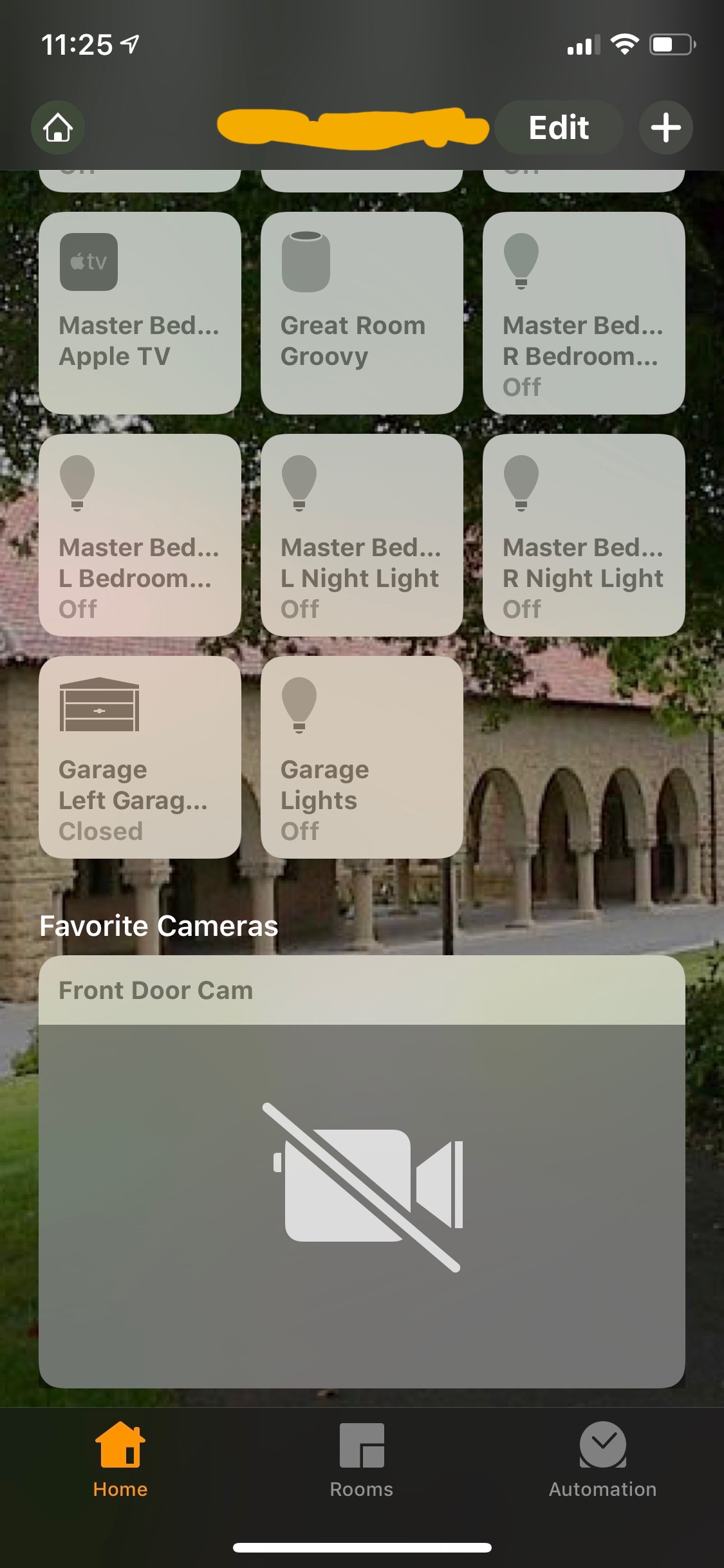

Trying to get this working on my MacOS Mojave rig. homebridge starts up, Camera-ffmpeg reports a snapshot from the Camera (never see an image). From the Home app on iOS, I get a placeholder for the video. When I click it, homebridge says “Start streaming video from Front Door Cam with 640x360x132kBit”, then immediately reports “ERROR: FFmpeg exited with Code 1”. Here’s my config.json:{

} . Screenshots:
Any thoughts as to why ffmpeg doesn’t seem to be working? I followed the Reddit guide.

Many thanks for your help! Fixing the source line stopped the error from being thrown, but no video yet. ffmpeg logs a ‘Start streaming video from cam’ message, then immediately stops, with a ‘Stopped streaming message’. No video ever shows in the Home app. I gotta think that it’s something with ffmpeg, but I may be wrong.
