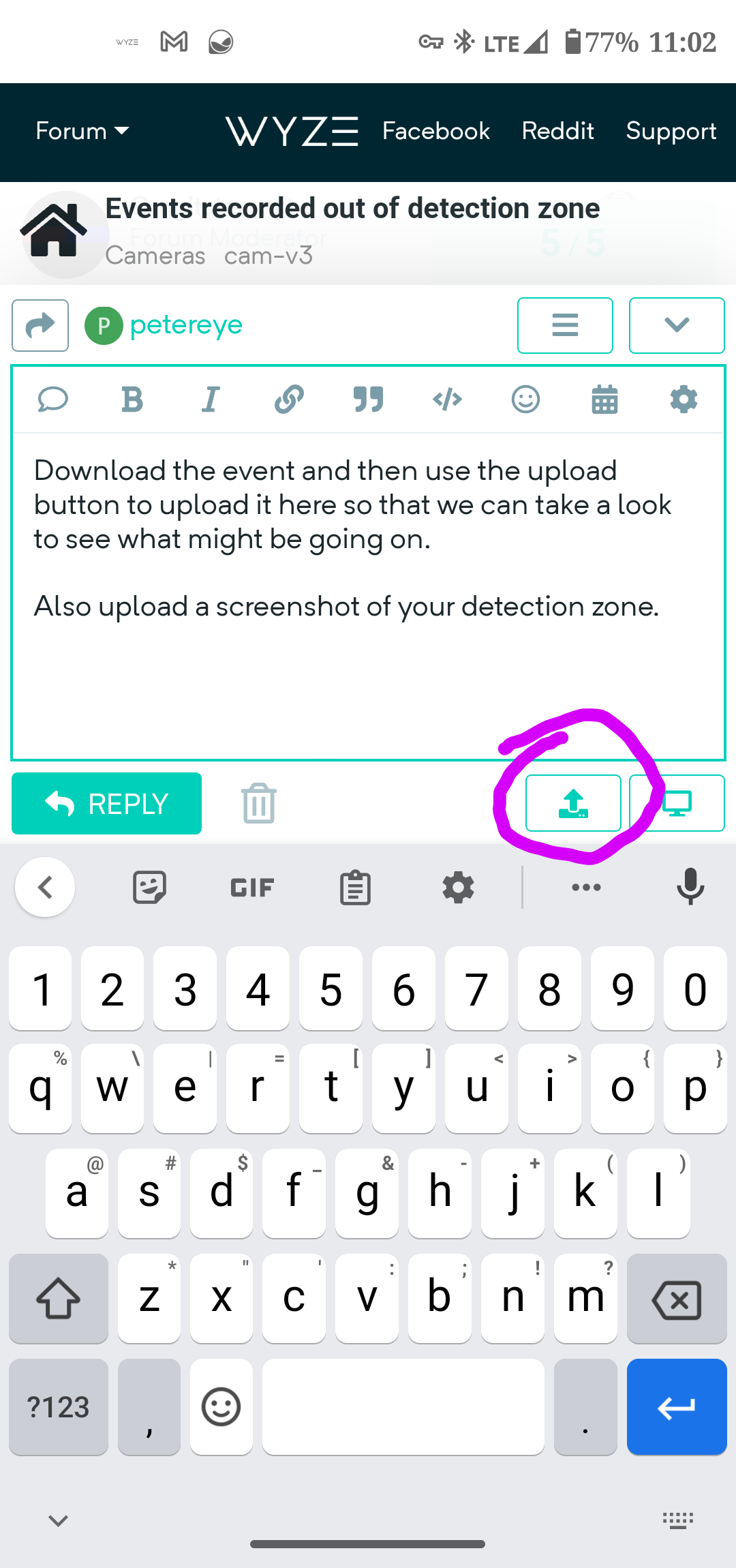

Download the event from the events tab and then use the upload button to upload it here so that we can take a look to see what might be going on.
Also upload a screenshot of your detection zone.
