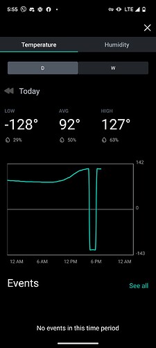

I put a climate sensor V2 in my attic to keep an eye on my humidity since we recently had our house repiped due to pinhole leaks. The other day I get a text from the monitoring service saying that they detected freezing temperatures and wanted to know if I needed help. Keep in mind this is July in California. We don’t have freezing temperatures this time of the year. I replied, it’s over 100° outside, I’m not sure why you would detect any sensor reading freezing temperatures. I said I will check all my sensors, because obviously one must be malfunctioning. I opened the Wyze app and discovered the sensor that I had put up in my attic was reading -123°. I looked back on the graph and saw that it went from 123° then dropped down to a negative 123°. I removed the sensor from my monitoring settings on the app, so that this would not cause another false alarm, but left it up in the attic just see if it would happen again, It did happen again, Everytime the temperature reached 123° then it drops to negative 123°. Any suggestions??

That is really interesting that when it reaches maximum high temperature it automatically reverts back to the bottom of the scale instead of just staying up at 126F.

Sure i will do that now as it is currently showing -128⁰ lol boy that’s really cold lol
I have never submitted a log before, should i just type in the issue or will the log show the issue and by the way it just changed to 126⁰ at least it’s not freezing anymore lol. The graph shows it is all over the place. Thank you for your help with this. I wasn’t even going to say anything about it, i figured the attic was to hot for it. I didn’t even realize there was s temp minimum or maximum that it could be used at. But figured i may as well report it since i didn’t see it posted by anyone else. Hope it turns out to be helpful to Wyze as i am a big fan, it’s not perfect but what technology ever is?

The Climate Sensor units actually report temperatures well in excess of stated upper/lower limits. Unfortunately, the app does not interpret and correctly display the sensor values beyond the app defined limits. The upper limit per the Wyze app is 128F. Above that limit, the reported temp is flipped negative. For example, 129F is reported as -127F (-128 +1), 130F is reported as -126F, etc. The graph is appropriately whacko with these readings:
And worse, because temp is a factor in the relative humidity algorithm, humidity is completely whacked when temp exceeds 128F:
The same issues hold true for the app’s lower limit.
I’m not sure, but the latest beta app may now have the display of the upper limit capped at 127F. I.e., any value above 127F may be displayed as 127F. I’ll keep an eye on this to confirm, but forecasted ambient temps may not support my test scenarios until next week (don’t have time to simulate with a heat gun).
