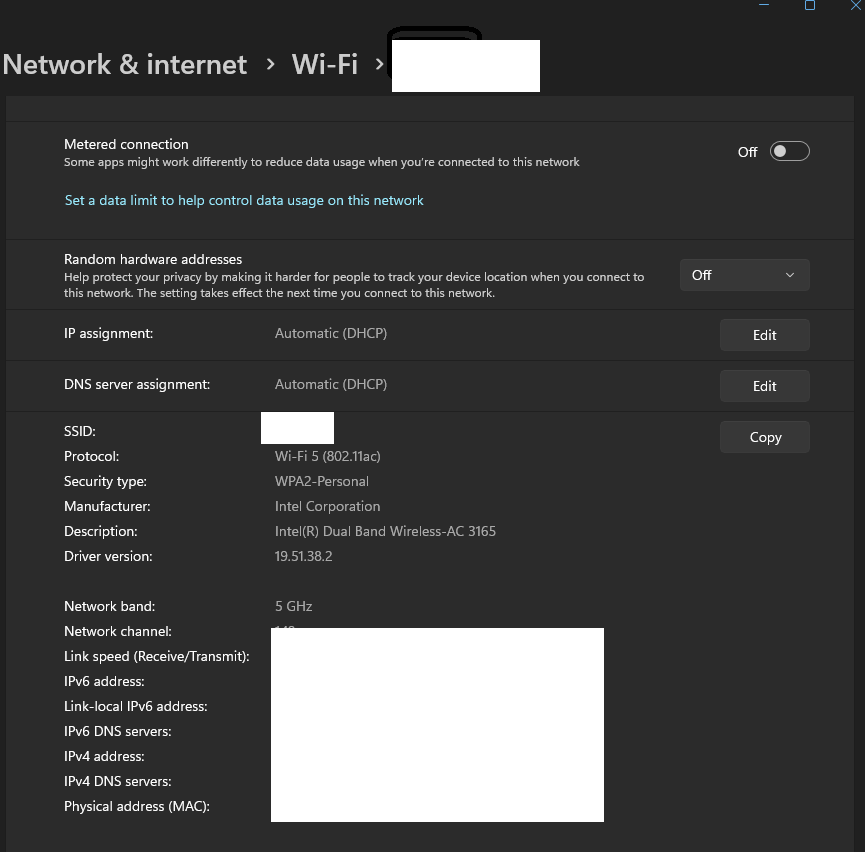

Here is a screen capture of my TP-Link settings for 2.4GHz. Can anyone help identify an issue?
What I have done:
  • Confirmed that there are no WiFi conflicts (SSIDs are unique for 2.4GHz, 5GHz), the previous WiFi network was shutdown.
  • Temporarily disabled the 5GHz WiFi.
  • Temporarily switched Channel width to 20MHz and Channel to 9 (to match previous WiFi settings).
I’m at a loss!
It may also be important to note that ALL my non-Wyze applications, like Kasa, etc. are all functioning normal on the 2.4GHz WiFi network.
