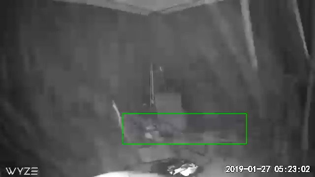

I turned the status light off so the blue light on the back is off.
There is a clip every five minutes all night long.
image image image
That looks pretty thick. Any chance it is fog, mist, drizzle or steam? I’ve had that and it looks like thousands of insects.
