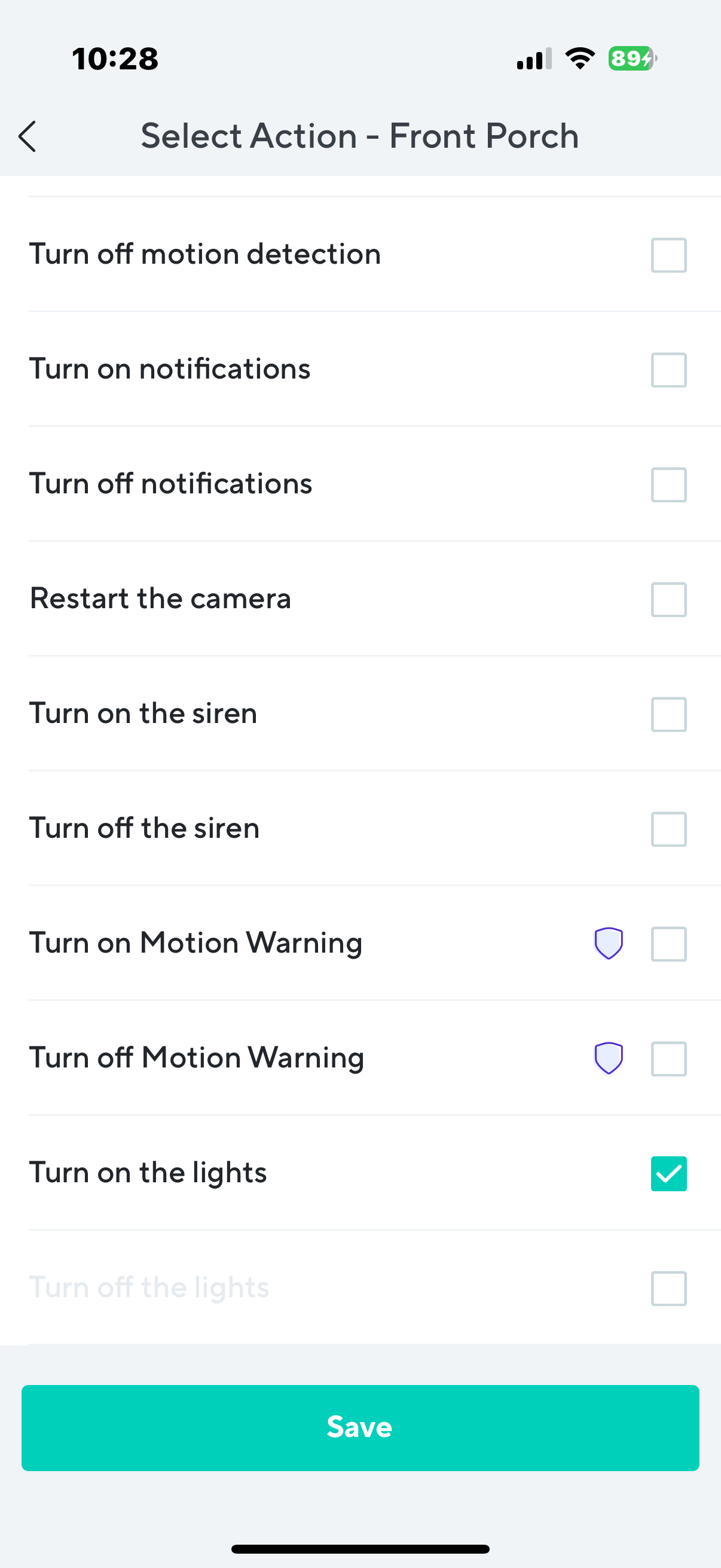

If you have a spare Wyze Plug or a Plug Outdoor with an unused outlet, then this should be fairly straightforward, because you can use one of those devices as a logical switch in Device & Service Trigger Automations as a bridge from/work-around for the Alexa integration. The Plug wouldn’t be used for controlling power to anything; it would just need to be plugged into AC and connected to Wi-Fi. You’d create one Automation so that when the Plug turns on your Bulb Cam’s “Turn on the lights” Action fires, and you’d create a second Automation for turning the Bulb Cam’s lights off when the Plug turns off. Then when your wife tells Alexa to “turn on the dingus” (or whatever name you give the Plug in Alexa) the Bulb Cam’s lights turn on.

I hope that makes sense. If you have a Plug and want to try it but need help with the Automations, then please let me know.
