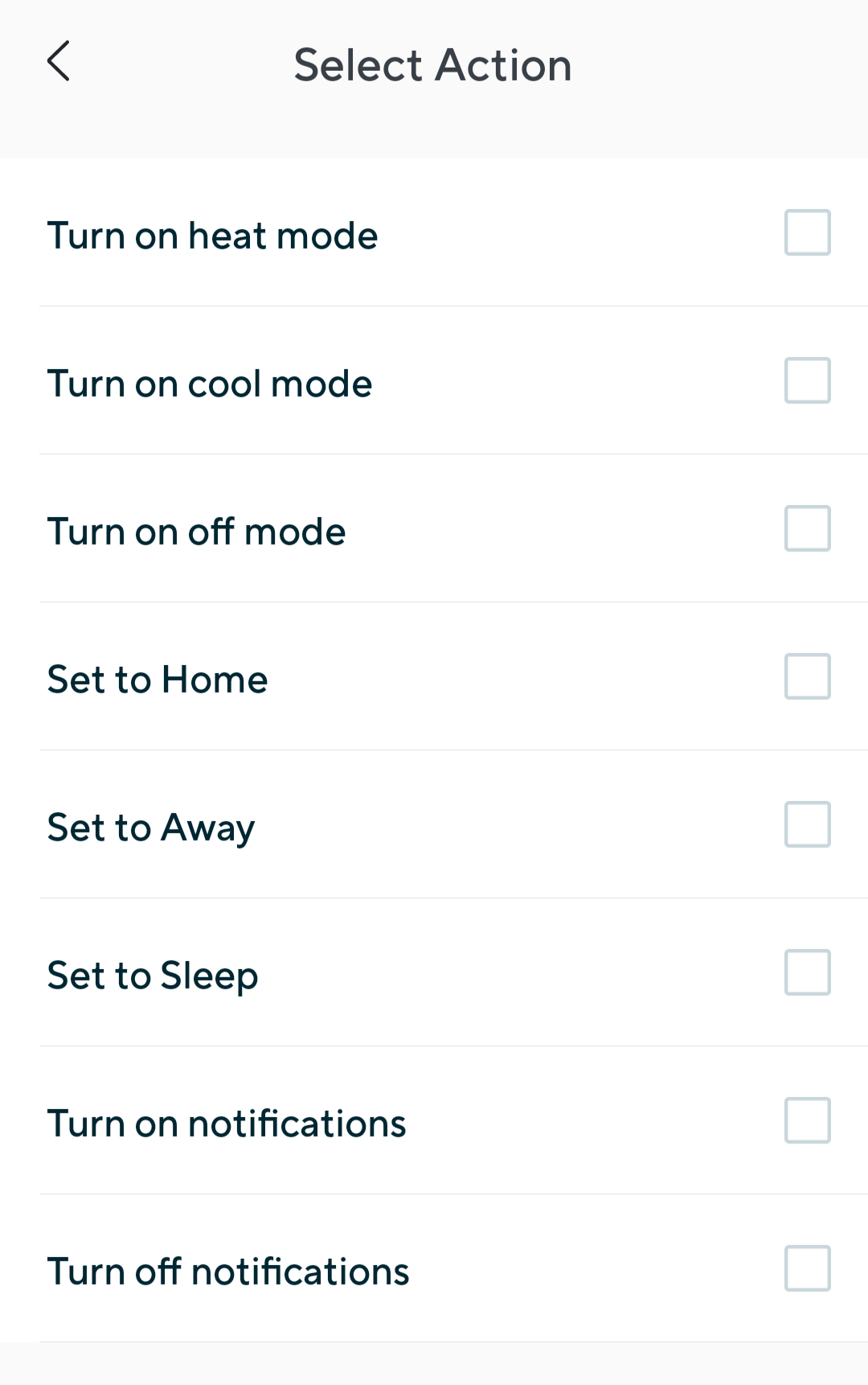

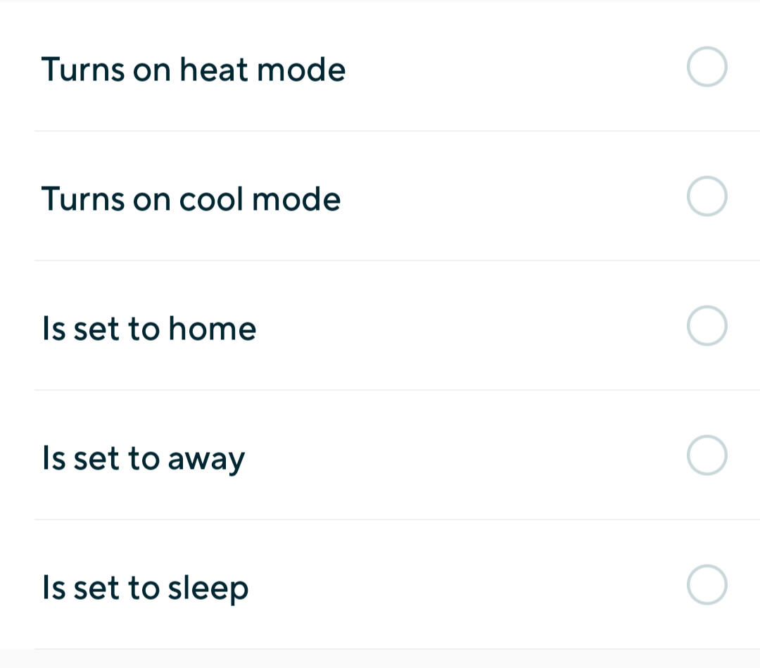

Currently the Wyze Thermostat has but 5 triggers:
None of these are suitable for the purpose of this discussion because the HVAC fan status cannot be used as a trigger nor the current Thermostat temp.

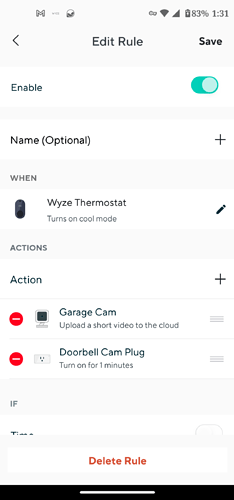

On a hunch, I created the following rule:

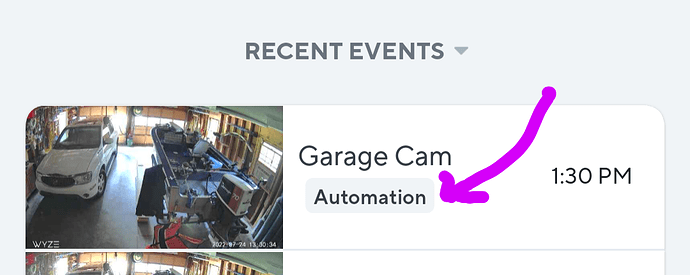

I took my doorbell cam plug and borrowed it for this test and plugged in a small fan to that plug. Just for giggles, I also told the rule to upload a video on my garage cam when the rule is triggered.
The Thermostat triggers “Turns on Heat Mode” and “Turns on Cool Mode” are actually when the thermostat turns on the fan and starts a heat or cool cycle.
My thermostat is in Auto Mode. When the temp went above my setpoint, the call for AC came from the Thermostat and a cooling cycle started. The rule turned on my plug and my little fan ran for it’s prescribed 1 minute. Additionally, my Garage cam uploaded the video I asked for and labeled it as “automation”.
What found as useful is that I can view the runtime history from the plug on a much smaller timescale than the Thermostat usage data graphs provide.
But, the problem here is that there is no “Turns Heat Mode Off” or “Turns Cool Mode Off” trigger to then turn the Wyze Plug off. I removed the timer function from the rule and just had it turn the plug on.
The rule turns the plug on, but without using the timer function within the rule, there is no way to turn it back off when the AC shuts off. My little fan just kept on running after the AC shut off.
We need more Thermostat Triggers.

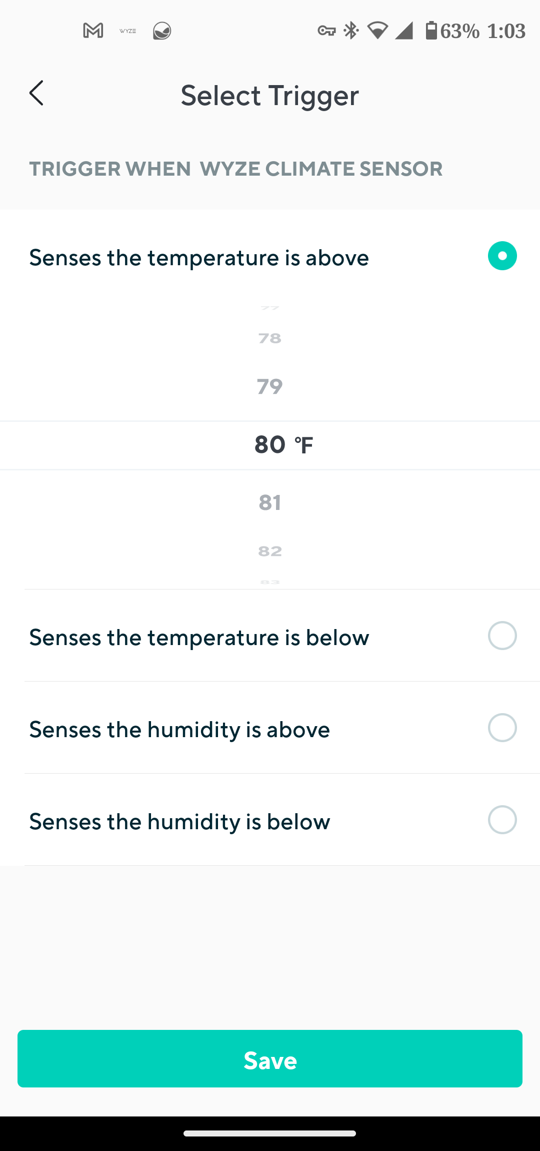

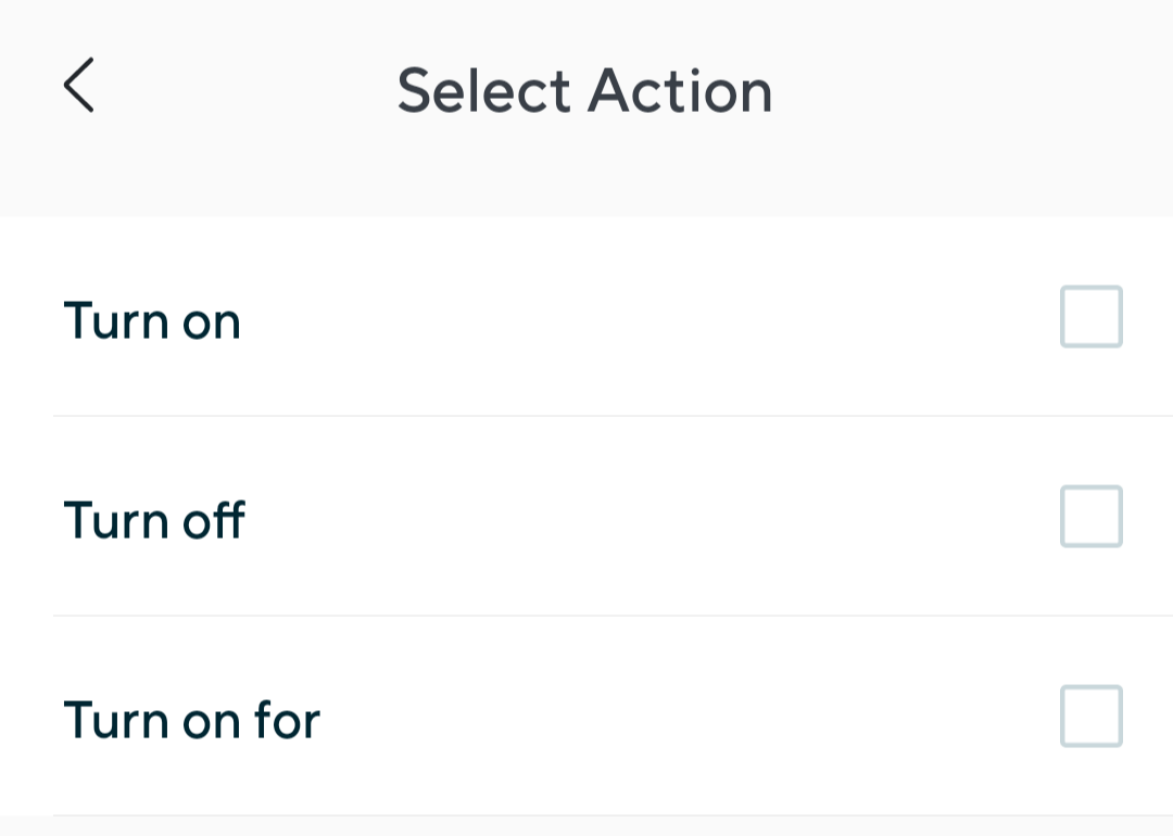

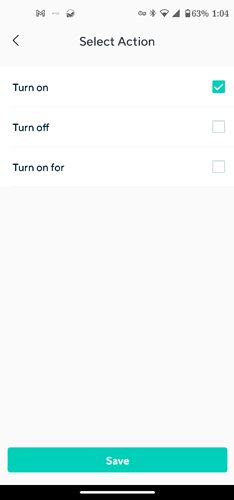

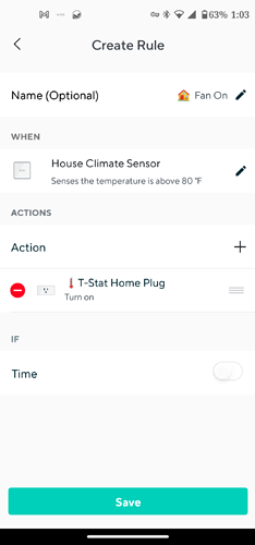

Currently the functionality you desire can be accomplished with the Wyze Smart Plug and the Wyze Climate Sensor (Sense Hub required) provided the space heaters draw less than 15A.
How is this configured between the climate sensor and the plug. A cursory search through Wyze FAQ on the climate sensor and smart plug does not describe the use case of the climate sensor controlling the plug. Is this combination a DIY effort of trial and error?
This is a simple rule (SS1) utilizing the native Rule Triggers of the Climate Sensor (SS2) and the native Rule Actions of the Plug (SS3).
This is only the ON rule. I also have an off rule for when the temp is below to 75°. Your on and off temps would be reversed since you are using it to heat. I am using it to control an attic vent fan.
Alternatively, you can use just one rule and have the plug power on for X minutes. You can also restrict the rule to only execute during specific hours.
