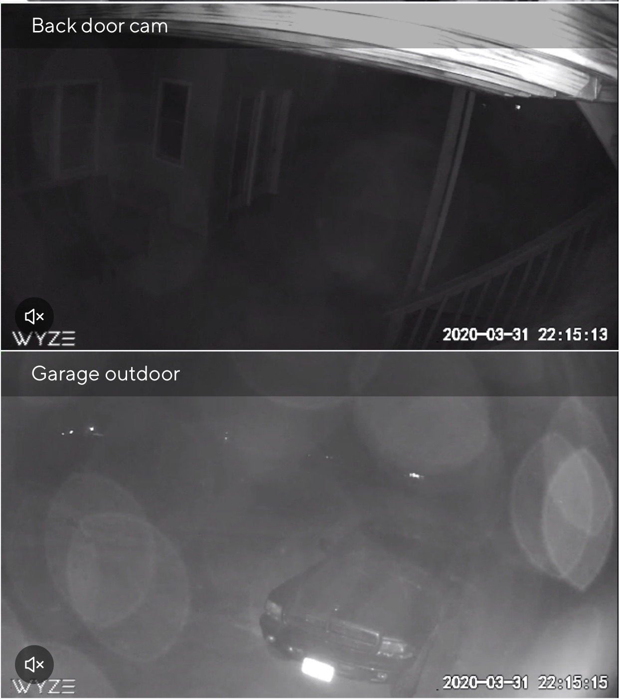

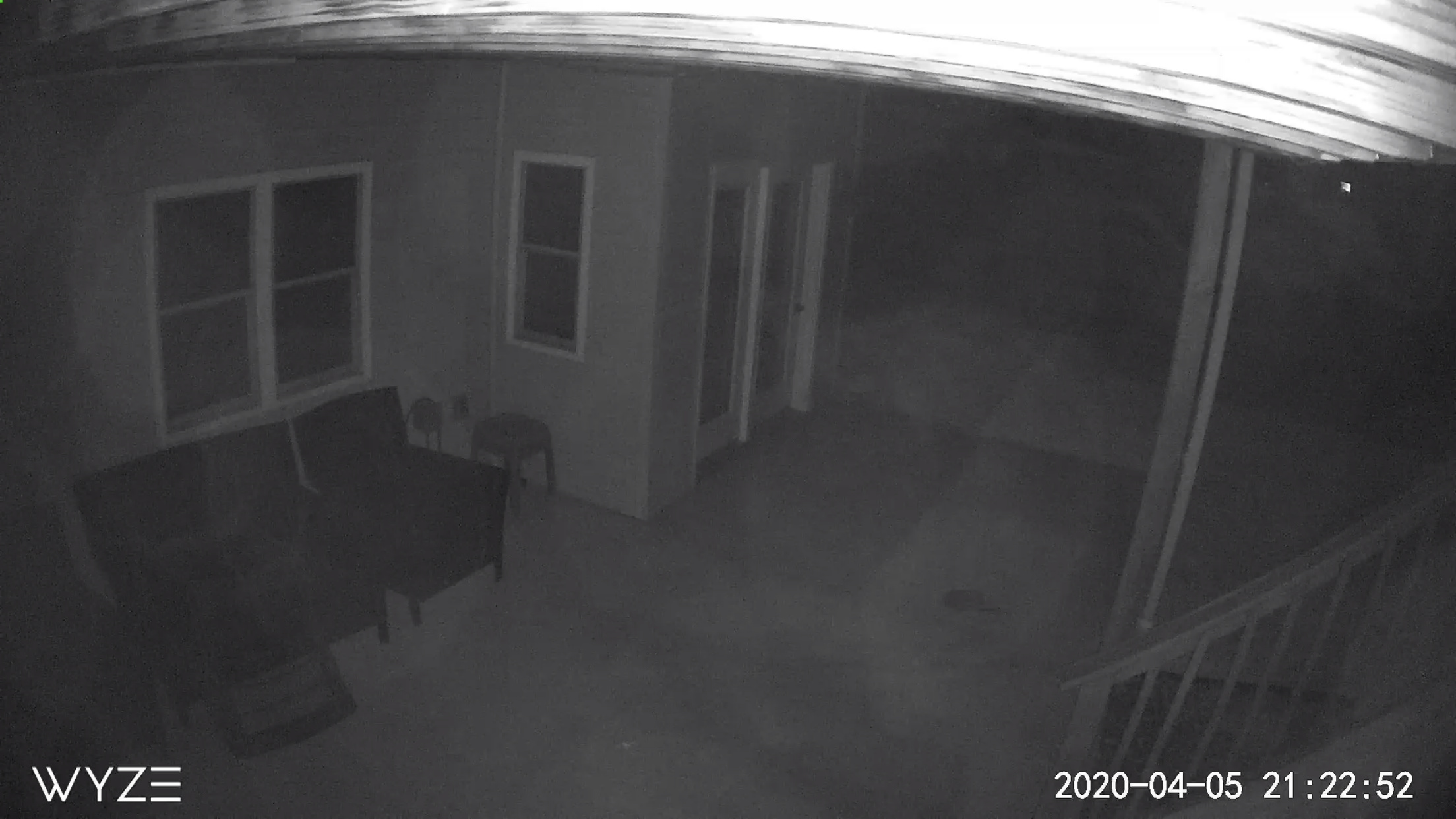

So the pictures at night with these cameras sucked. And someone told me to take a black marker and mark the underside of the lip and right around the lens and that made a huge difference. But there’s still a little bit of improvement that can be done so I think I’m going to either get a new black marker because this one was going dead or use some black tape and mask off because you’ll see there’s a huge difference In the before and after pictures
Before I don’t have a before picture of the front yard camera but you can see it’s very clear now
After
You definitely want flat black, no gloss to it If you have gaffers tape that might work, but the problem is getting anything to stick to silicone. . I used one of the silicone covers with a pan cam when I had it outside for a while and had that glare issue. I changed it out for a V2 and just put it under one of these covers for some protection. https://www.amazon.com/gp/product/B018WJQL0S/ref=ppx_yo_dt_b_search_asin_title?ie=UTF8&psc=1
