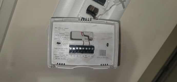

I am having an issue hooking up the Wyze Thermostat as well. At the wall thermostat I have 2 wires hooked up, 1 Red, 1 Green, and a spare white.

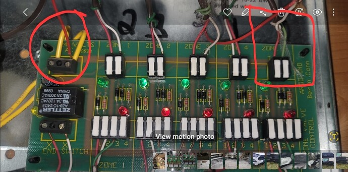

At the furnace area I have an Argo Valve control board.
Only two wires hooked up red and green. There is nonspot for anything else.
I tried hooking the white wire to the 24v after the transformer. I test with a multimeter I get 24v between the red and green, red and white, green and white. The thermostat does not come on. I hooked the white wire to the C spot on the Wyze thermostat. The red wire to the W1 and the green to the RC as the app suggests.

Generally TT terminals won’t provide enough current to run a thermostat from, but you could use an isolation relay. This diagram shows you the way to hook it up using only 3 wires, and power the wyze, but instead of an aquastat, you have a zone control)

By the looks of the diagram the two wires coming from the TT terminals don’t matter going to the isolation relay. I understand not liking to give recommendations, but would you have a link or part number for an isolation relay that you are talking about? Also, couldn’t I just use the two transformer terminals on the valve control board. I circled them in the control board picture on the top left. I tried splicing the spare white wite to one of the transformer 24v terminals to hook to the C on the Wzye to give it power, but that didn’t work. I had the 24v, but its not working. I have a C adapter that came with the Wyze Thermostat, but I don’t see how I could hook that up to make any difference. I’ve read people talking about supplying external power with an adapter of some sort that plugs into the wall…

You might be able to use the zone board’s transformer, as long as using it doesn’t cause chatter on any of the relays.
As for an isolation relay, I use 24V NO fan relays (emerson, supco, potter/brumsfield, packard, etc). Mostly because I already have them in my kit, but really any normally open 24VAC relay would do.
example: https://www.amazon.com/dp/B000LDCPQS/

I took your suggestion and ended up moving the red and white wires for consistancy like the other TT terminals.
Today I hooked up the C adapter that came with it as I figured I have nothing to lose.
I tested with my meter and as you suggested and I paid more attention this time to my readings and which wires.
The C-adapter:
I hooked the Red from the TT terminal on the Argo board to the W on the C-Adaper, the White from the TT terminal to the R on the C-Adapter.
The Green wire (white in my pictures I sent previously) that seemed to be a spare to the G terminal on the C-Adapter.
The TT left I hooked the R wire from thr C-Adapter.
The TT right I hooked the W wire from the C-Adapter.
I checked the wires continuity of the C-Adapter with my meter so I could understand that.
I then hooked the C wire from the C-Adapter to the left yellow terminal on my Argo board transformer and the G wire from the C-Adapter to the righ yellow terminal on the Argo board transformer.
I tested like you suggested. Prob on the left yellow Argo board transformer.
To the C-Adapter.
Y = 0v
W = 27v
R = 0v
G = 0v
I tested like you suggested. Prob on the right yellow Argo board transformer.
To the C-Adapter.
Y = 27v
W = 0v
R = 25v
G = 27v
At the thermostat I tested.
Red to White = 25.8v
Red to Green(C) = 27v
White to Green(C) = 0v
Now that I had that, I was able to hook up the Wyze Thermostat.
Red Wire = Rc slot
White Wire = W1 slot
Green Wire(C) = C slot
