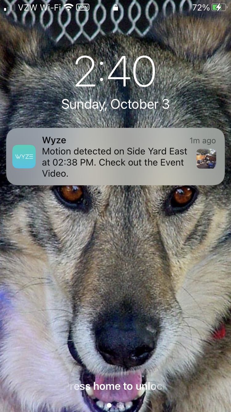

I have to disagree with part of you post. I have 4 WCO not on Cam Plus. They are all on scheduled event recording. I get the 12 second clips and notifications for all events. I posted a screen shot of this on 23 Sept on this post. I don’t even know if you can do scheduled recording “with” cam plus? And have it work.
Notification from a few min.ago WCO on SE recording.

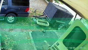

Are you able to get power to this location fairly easy? I have an idea. So it looks like your wco is mounted under an overhang, and that is good because it’ll protect the wco for this mount idea. Mount the camera upside down, this will make the pir detection zone be on the top 2/3 of the frame, as opposed to the bottom 2/3 it is right now.

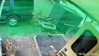

I believe this is about where the detection zone is right now. Goes up from the bottom to about the tounge of the trailer.
Mounting it upside down will include the area above the tongue, and give you more reach to the upper right.
Normally mounting the WCO upside down might compromise it’s ability to keepit’s safe from water in the elements, but since it’s under an overhang I think we’re okay in this spot. If you there’s any reason you may think that water the elements could get to the underside of it mounted upside down I’d say just keep it mounted upside right to protect the camera.
