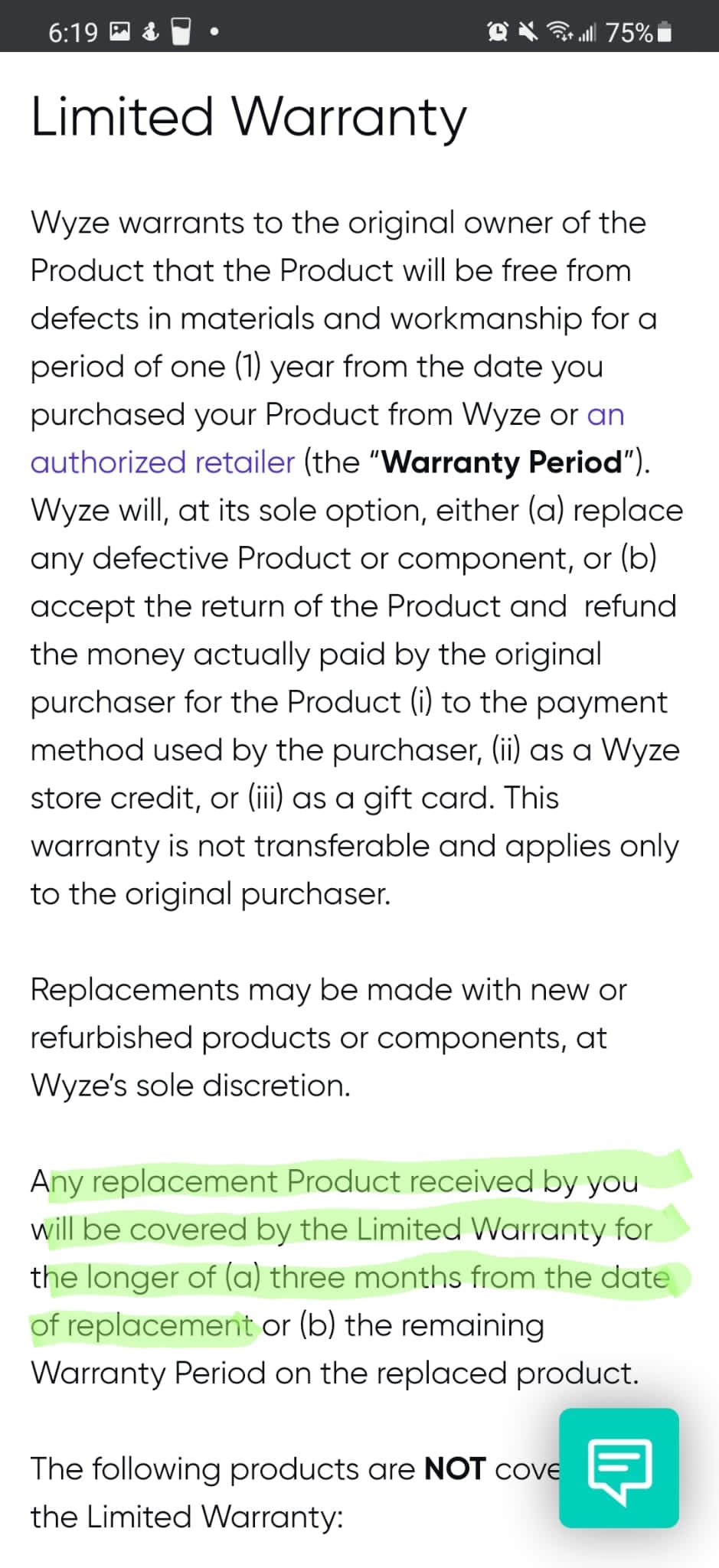

Update:
Sure looks like Wyze is not really confident in what it sales… So yeah… Enjoy while your cams last. I have just received 3 replacement that I will never update… We will see how they hold up.
