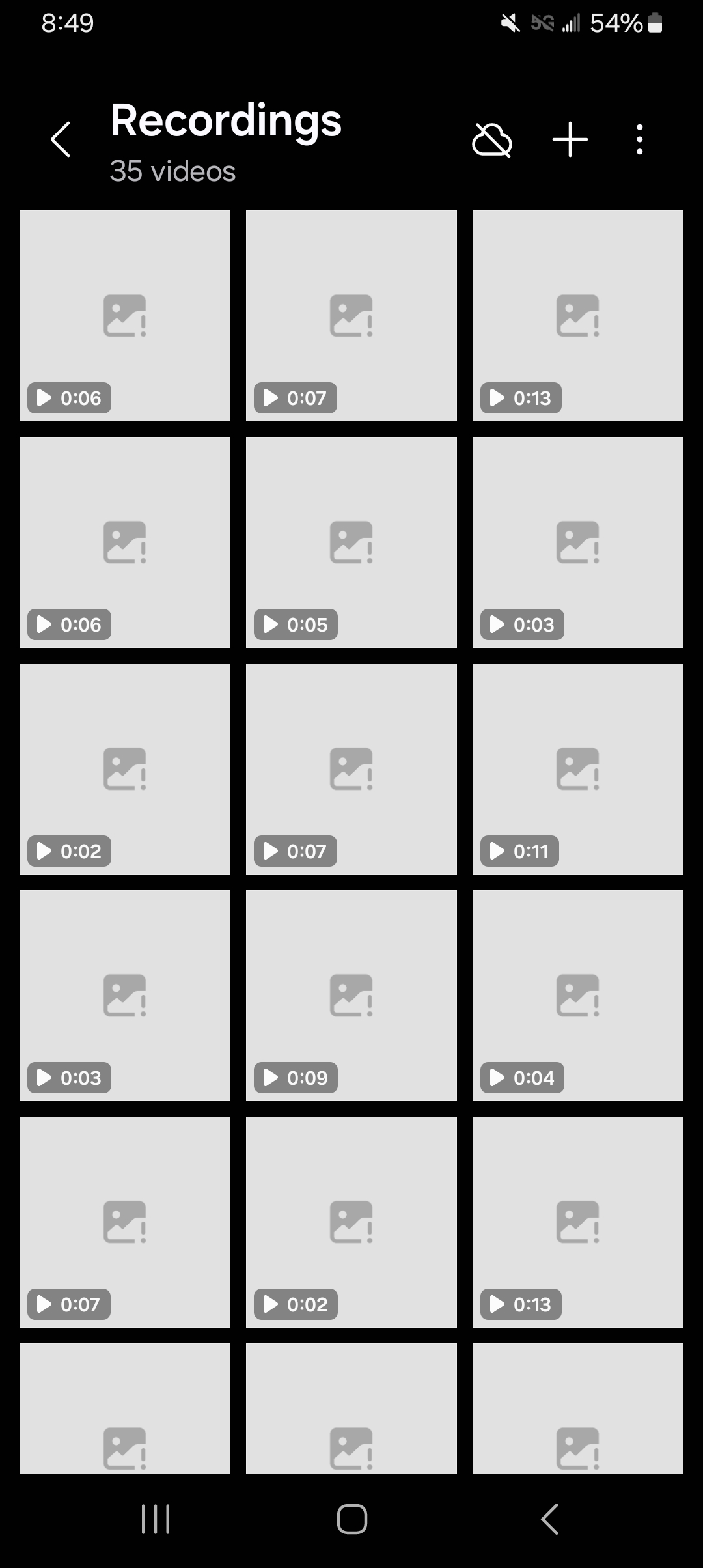

Anyone know why i can view the recordings through the wyze app but when they go to my gallery they are unplayable? Ive tried to send them to other devices and get the same result. Seems kind of useless and a complete hassle if anyone ever needs the footage from the camera.

I can view them in the album of the wyze app but when i hit record button and it saves to my phones gallery it wont let me open it. I cant send it anywhere else. Messages youtube or anywhere

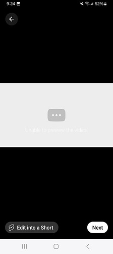

Well i guess it lets me upload the recordings to youtube from the wyze app. Good enough for me. Must be problem with my phone player or gallery.
Yeah the upload (share) to Youtube is a bit different (the wyze app does its own encoding in order to add the “captured on wyze” to the end), so it does sound like your phone may be the issue. Unfortunately I’ve never figured out a way to reinstall video encoders on android, it seems some apps have their own built in, and others use a system one. One time I was able to uninstall the gallery app and reinstall it for someone and that worked, other times it would not let me uninstall it (different flavor of android).

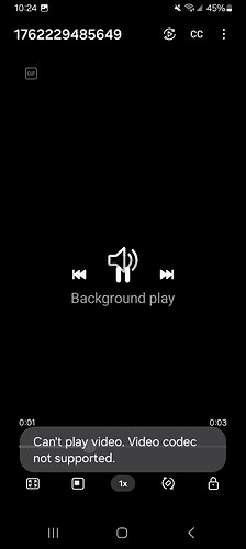

No bueno on the file manager own video player it says codec not supported or something. Decoder off also makes no difference.
