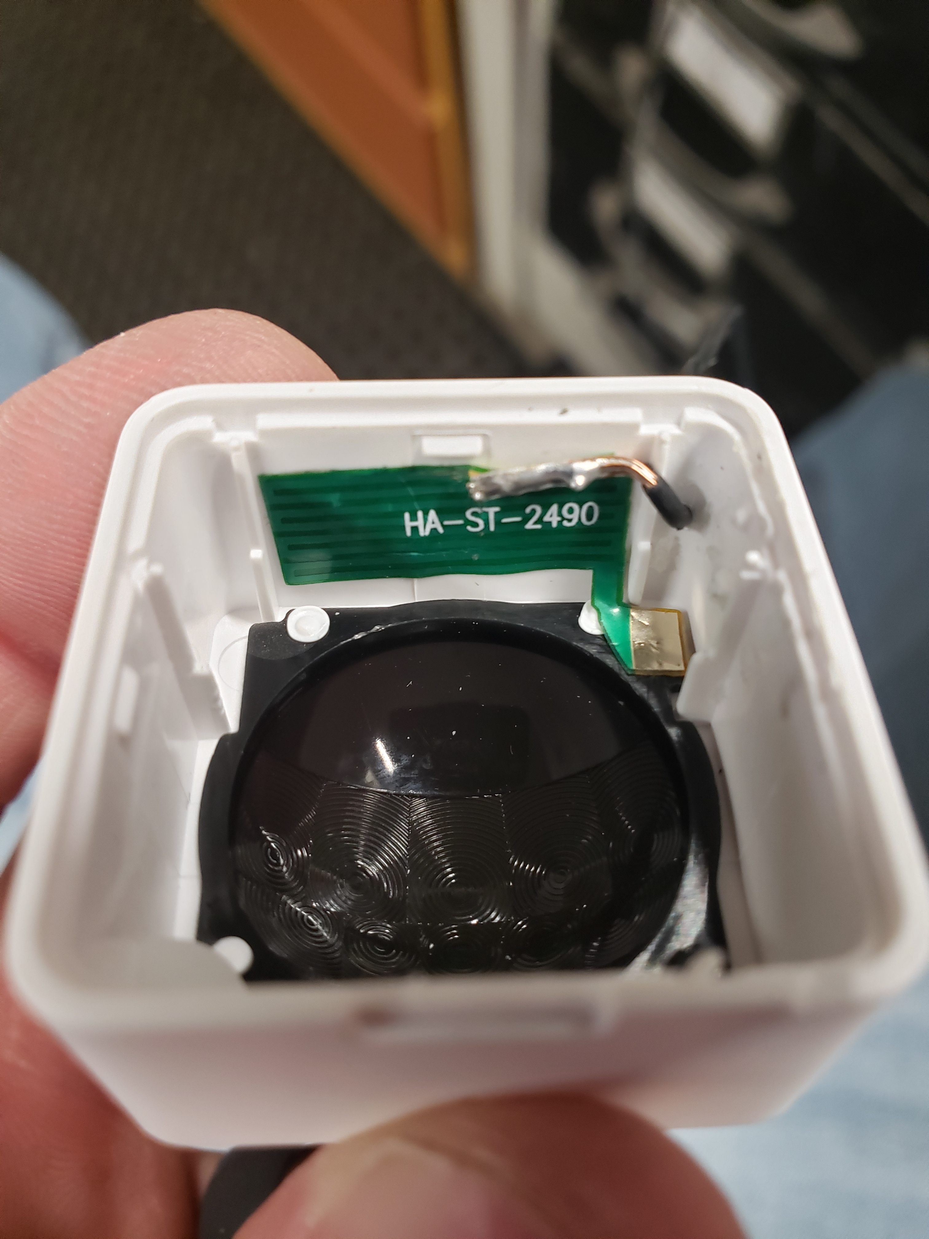

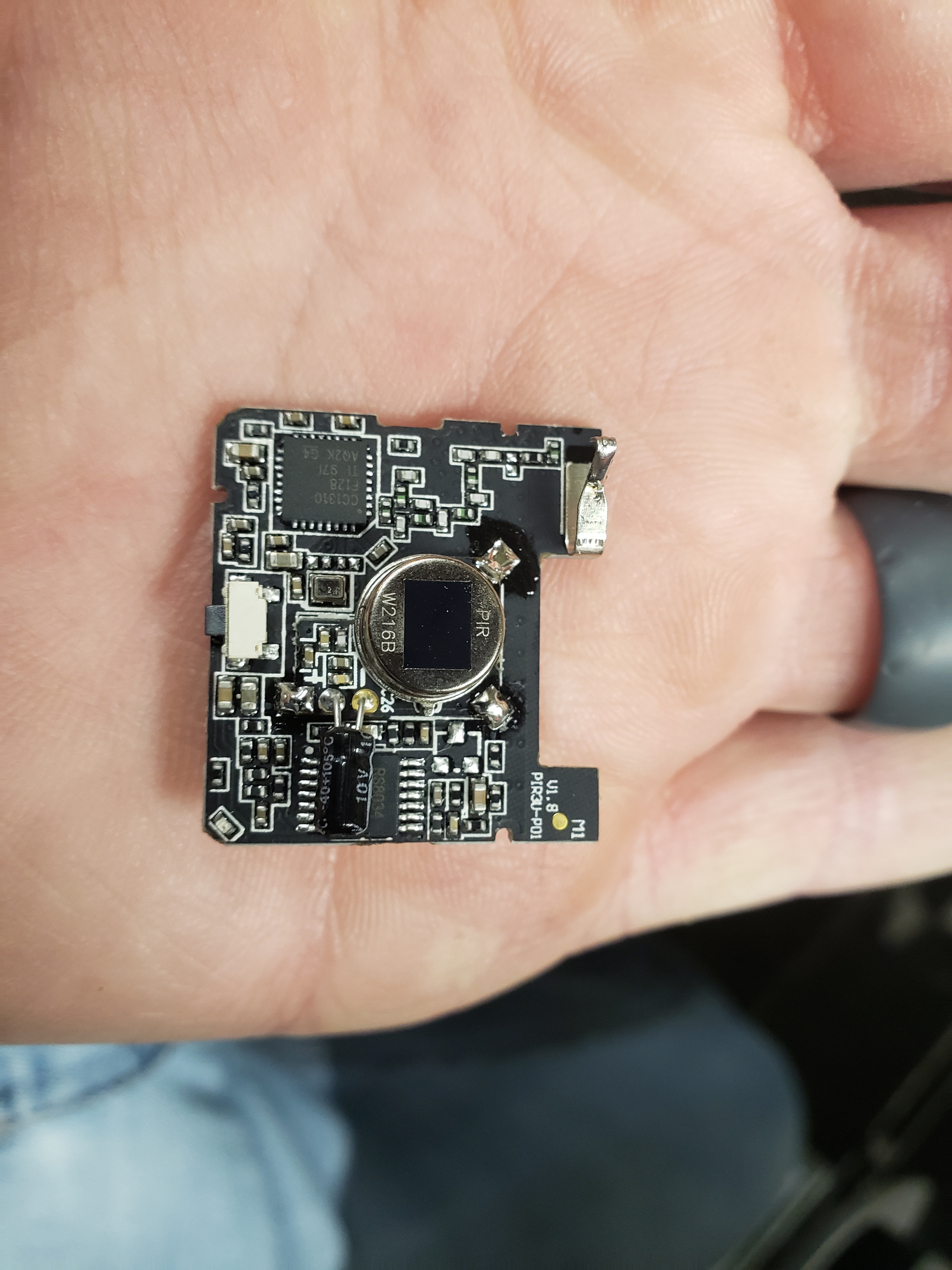

Well, I may have been successful on extending the range on the motion sensor. I soldered on a length of wire about 12" long. The sensor is in a metal mailbox, and i have the wire routed out of the mailbox. It has a one bar signal, but that’s good enough for now. I have the sensor bridge probably 15 yards and one wall (inside) away.
