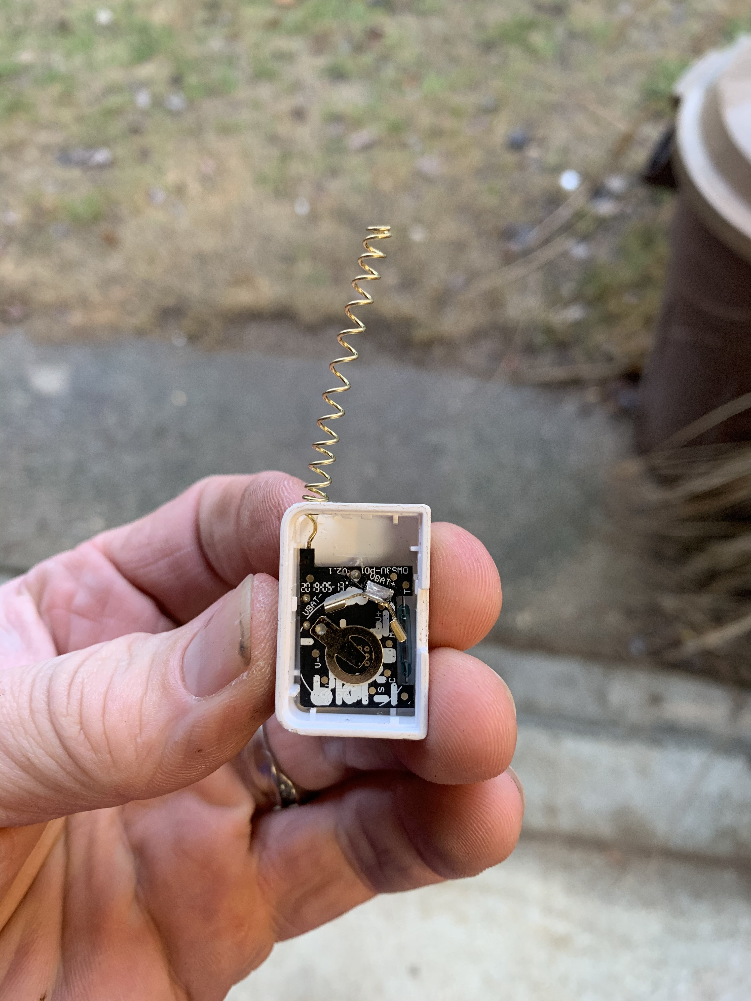

I drilled a small hole and uncoiled the one I was having trouble with out at my shed door. Also replaced the battery with a new Energizer. I was having the same issues of the sensor would send “open” notifications, but in the app always showed the door as open and never got any closed notifications. This took it from one dot of signal to two dots. Sensor is only about 25 feet from the bridge in an outdoor mounted V2 cam.
