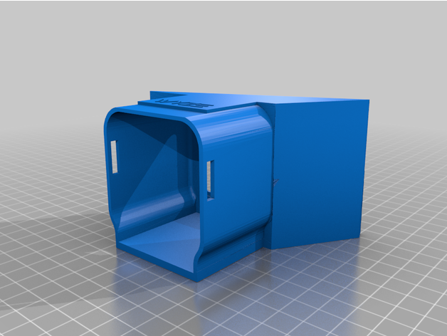

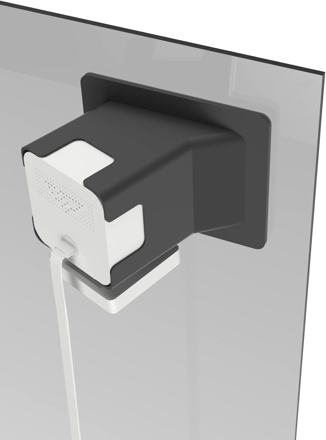

For sure that’s a genuine issue, and it’s something that I see with one of my Cams. I haven’t done a whole lot to try to mitigate it completely, but I’ve been curious about Wyze’s Window Mount, and what I probably should do is find/design/tweak a 3D model to fabricate and give me interior light blocking and the angles I really want from my outward-looking Cam v4s. Really, though, keeping rooms dark and drawing drapes behind them has given me acceptable results for my applications so far.

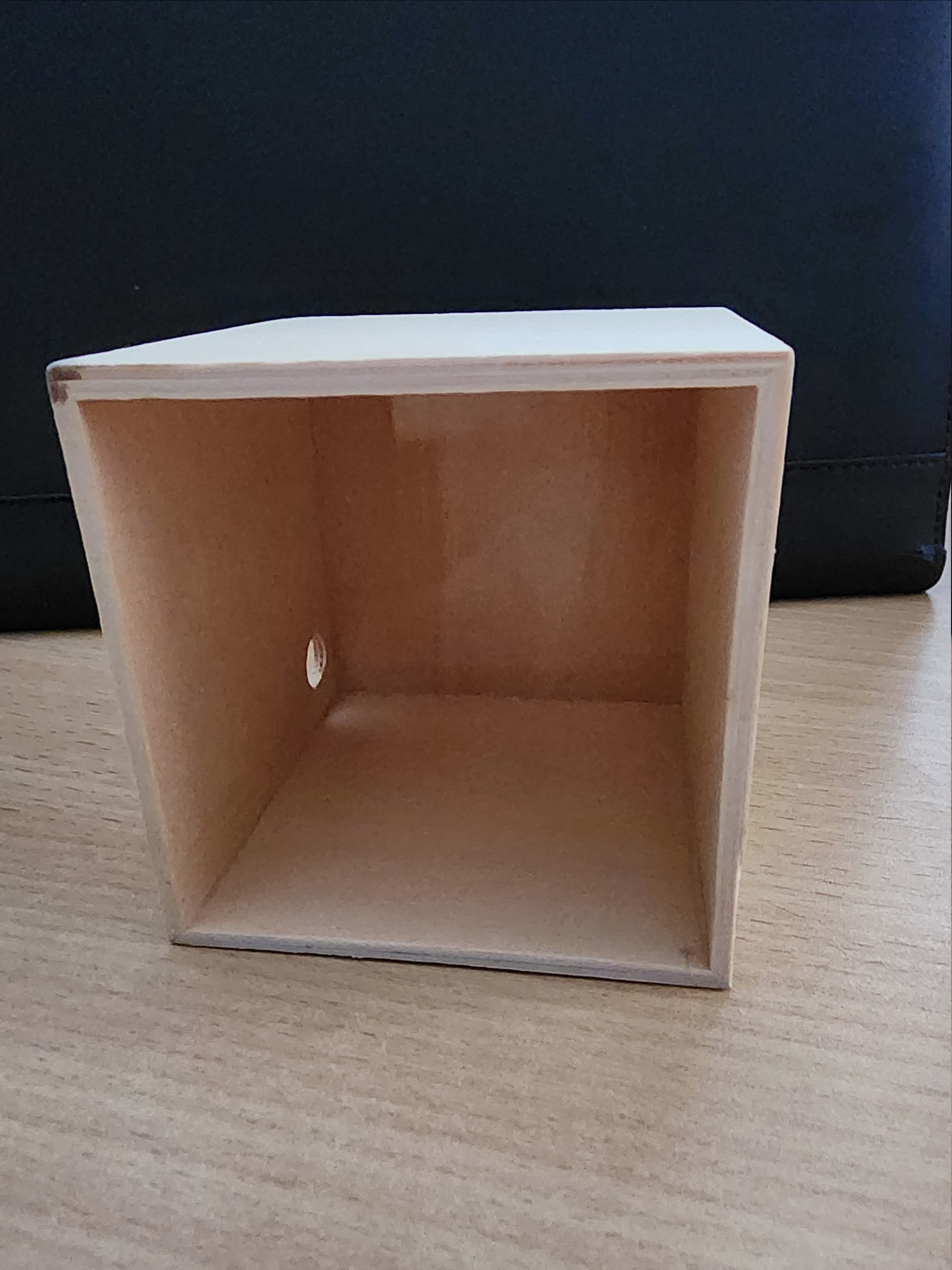

This is my low-tech solution to installing a camera behind a window. I came up with this well before Wyze introduced its window mount.
It’s a cube made from thin panes of balsa wood. I glued 2 small wood pieces to the sides, which have enough surface to use 3M double-sided sticky tapes. I drilled a hole (visible in the pic) for the USB cable. This blocks out the room light and still allow for a slight downward camera angle.

I always prefer home made solutions (especially considering I have pretty much every woodworking tool there is and plenty of wood around at all times).

I really like the elegance and simplicity of something like this. A box like that could be big enough to allow the camera to be rotated/tilted to the desired view, and you could even stick the metal mounting disc in it to keep the camera in place. Then you’d just need to seal out the light where the box contacts the window pane, eh?
Nice work. Thanks for sharing! :+1:

Here’s some ideas.
and
