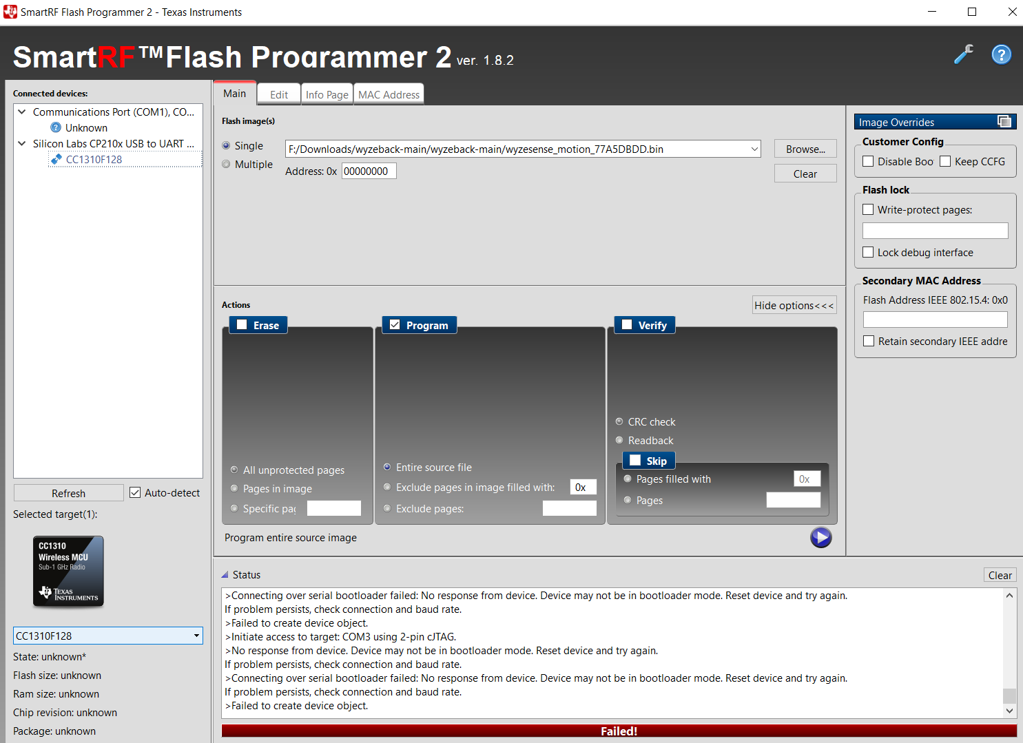

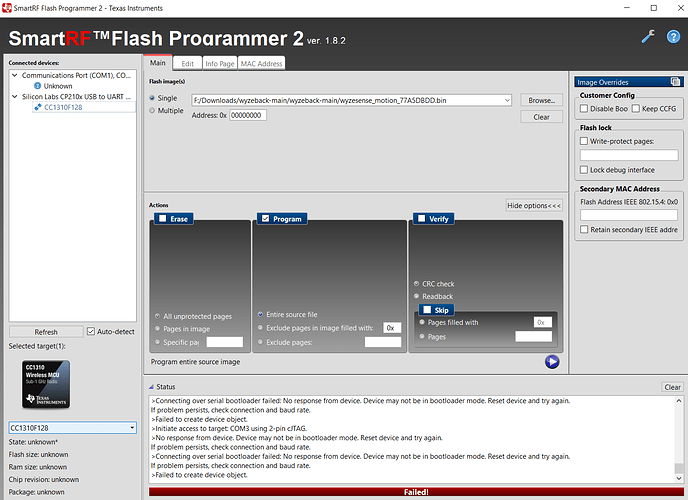

it seems the bootloader is not enabled and as such we most likely will not be able to use the cheap USB dongle USB/TTL ( I did try short RX with GND )
I do not plan to spend $40+ on the CC1310 Launch pad so this is it for me and Wyze.

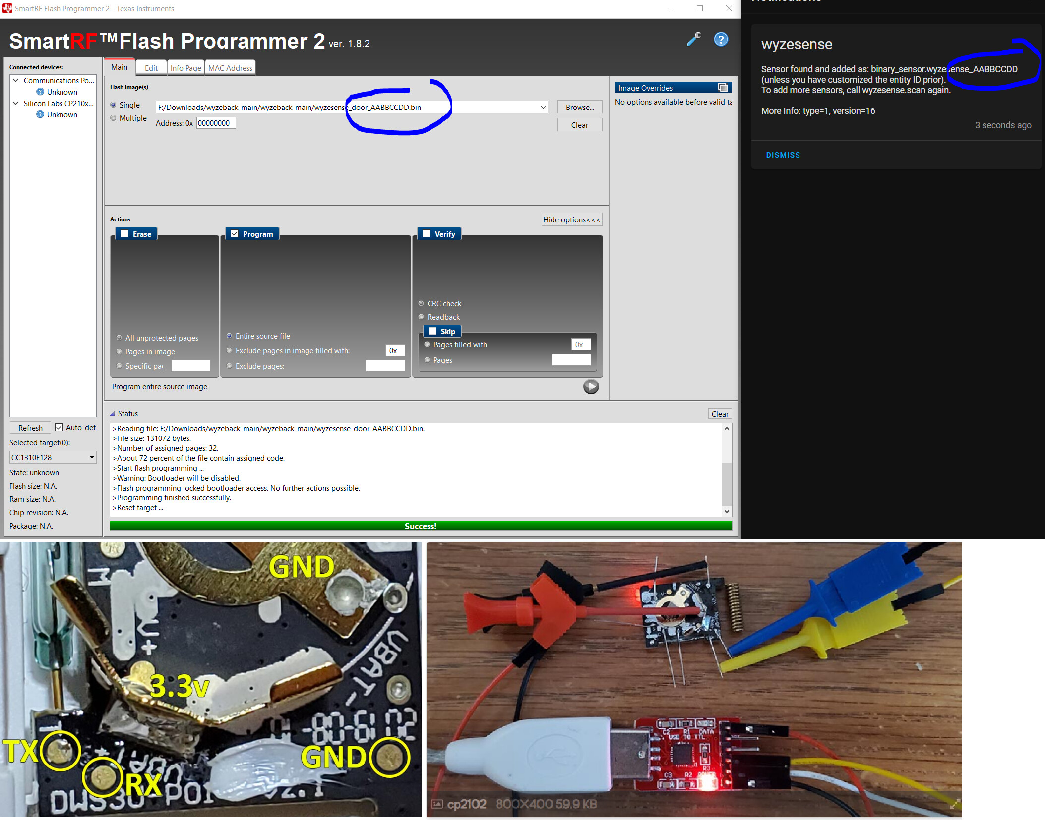

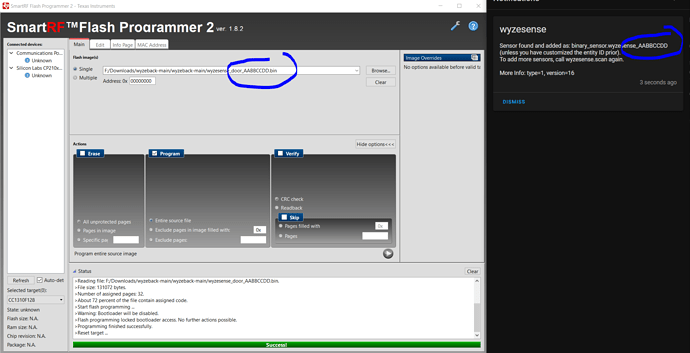

I was able to restore Door sensor using the cheap USB dongle, you can see that Home Assistant can recognize the new dummy MAC using this guide. All you need is 5$ USB CP2102-based USB and Flash Programmer 2 from IT
Thank you soooo much for this excellent writeup, @exeljb !
For other people who (like me) are completely new to hardware hacking, I figured out why UniFlash kept throwing errors like “IcePick: Error connecting to the target: (Error -2131 @ 0x0)”
I had to remove most of the jumpers from the CC1310 LaunchPad board. Basically look where the blue and green wires are connected in IMG_2205; that block of jumpers should all be removed. My guess is that if you don’t remove the jumpers, the debugger still talks to the LaunchPad’s built-in CC1310 chip, instead of sending signals to your Wyze Door sensor’s CC1310 chip via the TMS and TCK wires.

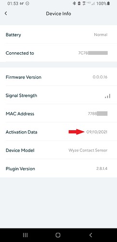

Brand new (2 years old) out of the box v1 sensor:
This works !!
