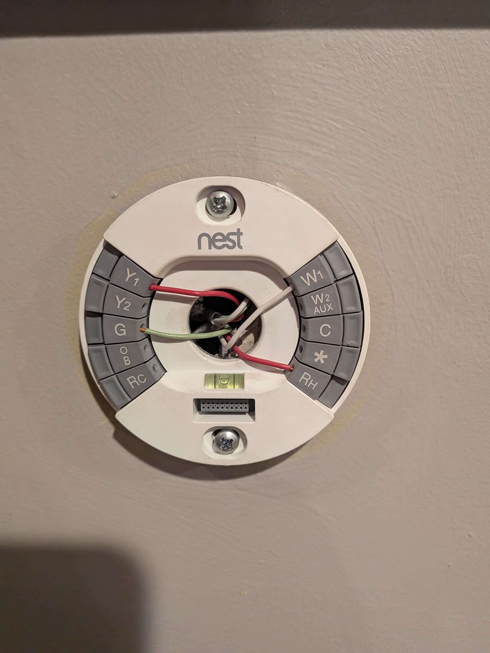

Thermostat no W wire on the control unit
I’m trying to install my new thermostat as my Nest Gen 2 has been disabled by Google

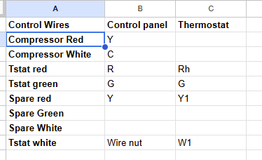

I don’t have a C-wire upstairs, but I do have 2x 3-wire runs going to it (an unused white and unused green wire)

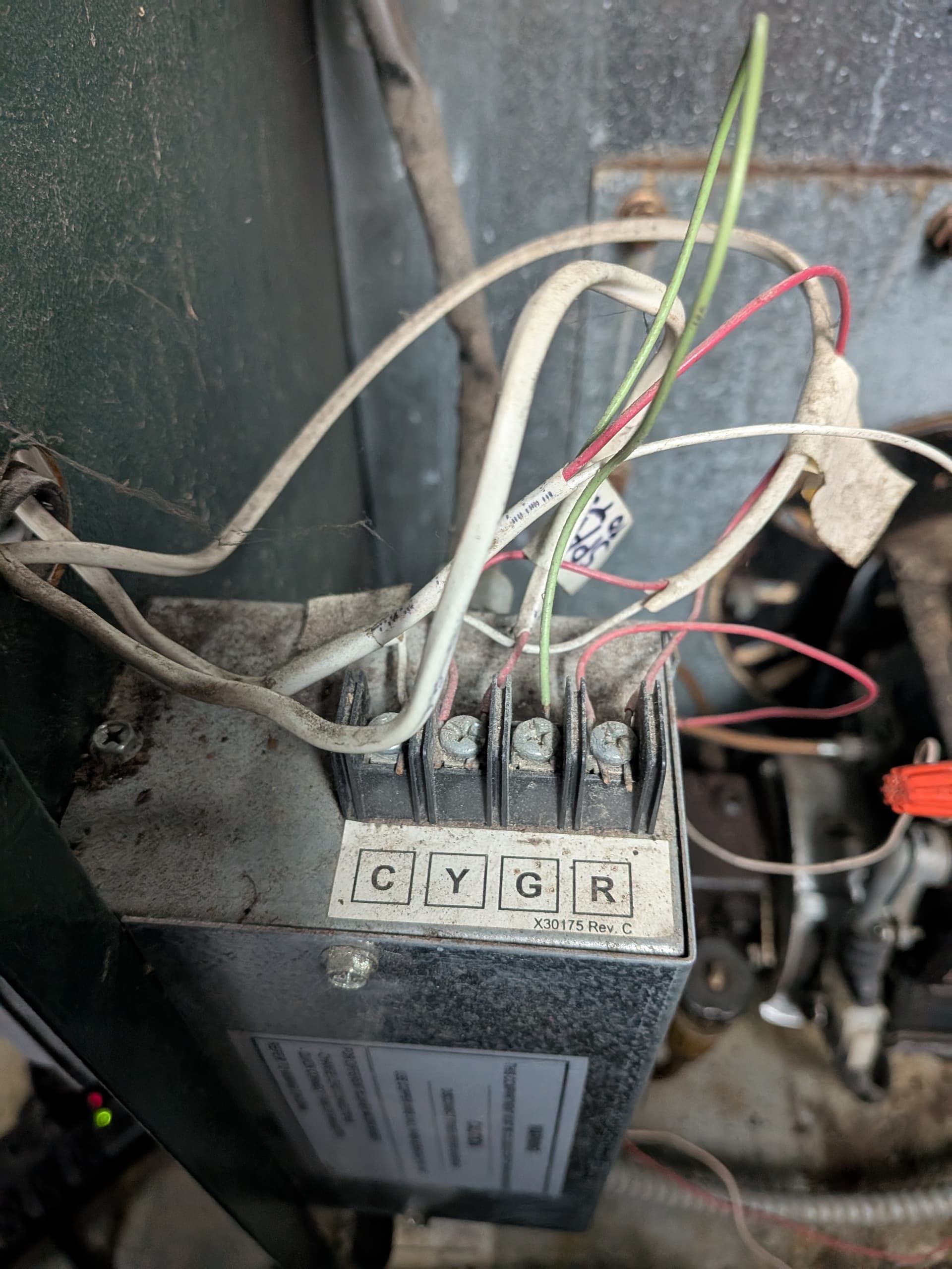

in the basement my heating system has 4 wires going to the controls but doesn’t have a W to intercept. It does have a C connection though
Could I take one of the unused wires in the 3 wire loom and connect that to C here and then wire it to the C-terminal upstairs?

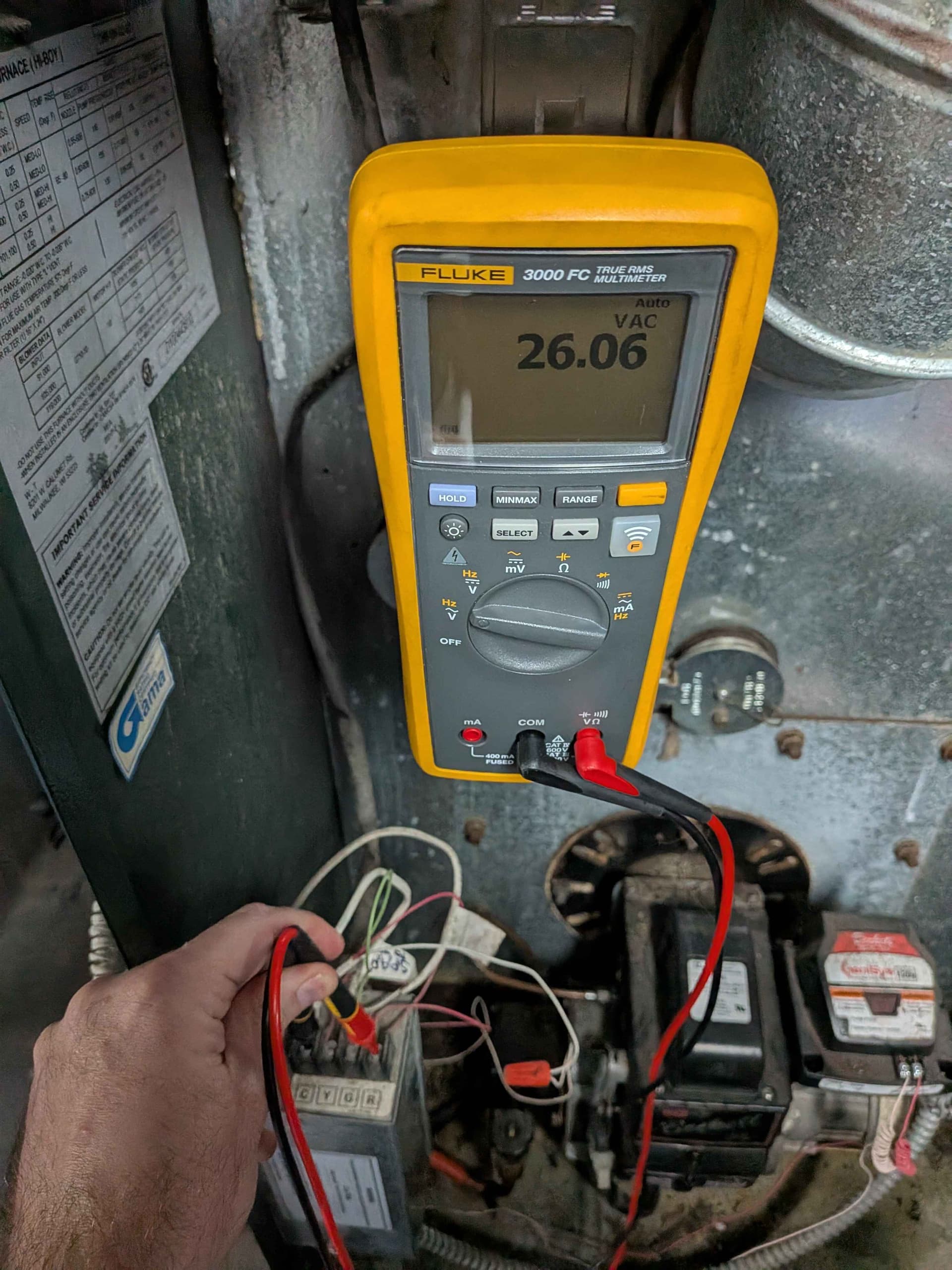

Here’s the Voltage reading off the C/R terminals on the control panel
I’m guessing this means I can take one of the spare unused wires and connect it to C down here and C up there?
Yes, you can use any spare wire as a C wire, as long as it is connected to C on both sides.
