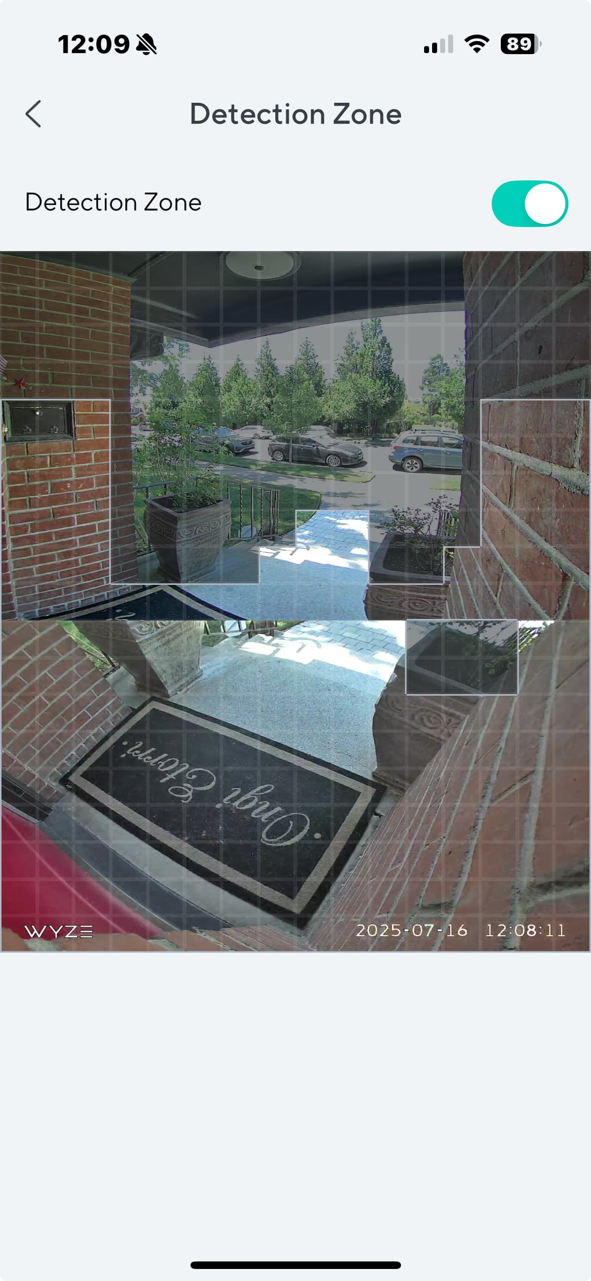

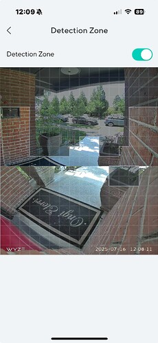

adding setup images

The images you shared are helpful. Thanks! :+1:
I think the Detection Zone looks pretty good, but I wonder if something in the excluded area is still causing enough pixel change that the camera is interpreting that within the zone you set. What I mean is that when you have Motion Tagging enabled (as you do), if you watch events often you’ll see the green Motion Tagging box move and shrink and grow moment to moment as it follows a target within the video, and sometimes an edge or corner of the box where movement is being interpreted can encroach upon the Detection Zone, indicating that it triggered the event. A couple of other things to try:
  1. Share some event captures that show the green Motion Tagging box so that they can be compared to what you’ve set for your Detection Zone.
  2. Enlarge your exclusion (greyed) area a little to give your Detection Zone more of a buffer and see if that reduces the notifications you’re seeing while still alerting you for things that you want to be notified about.
