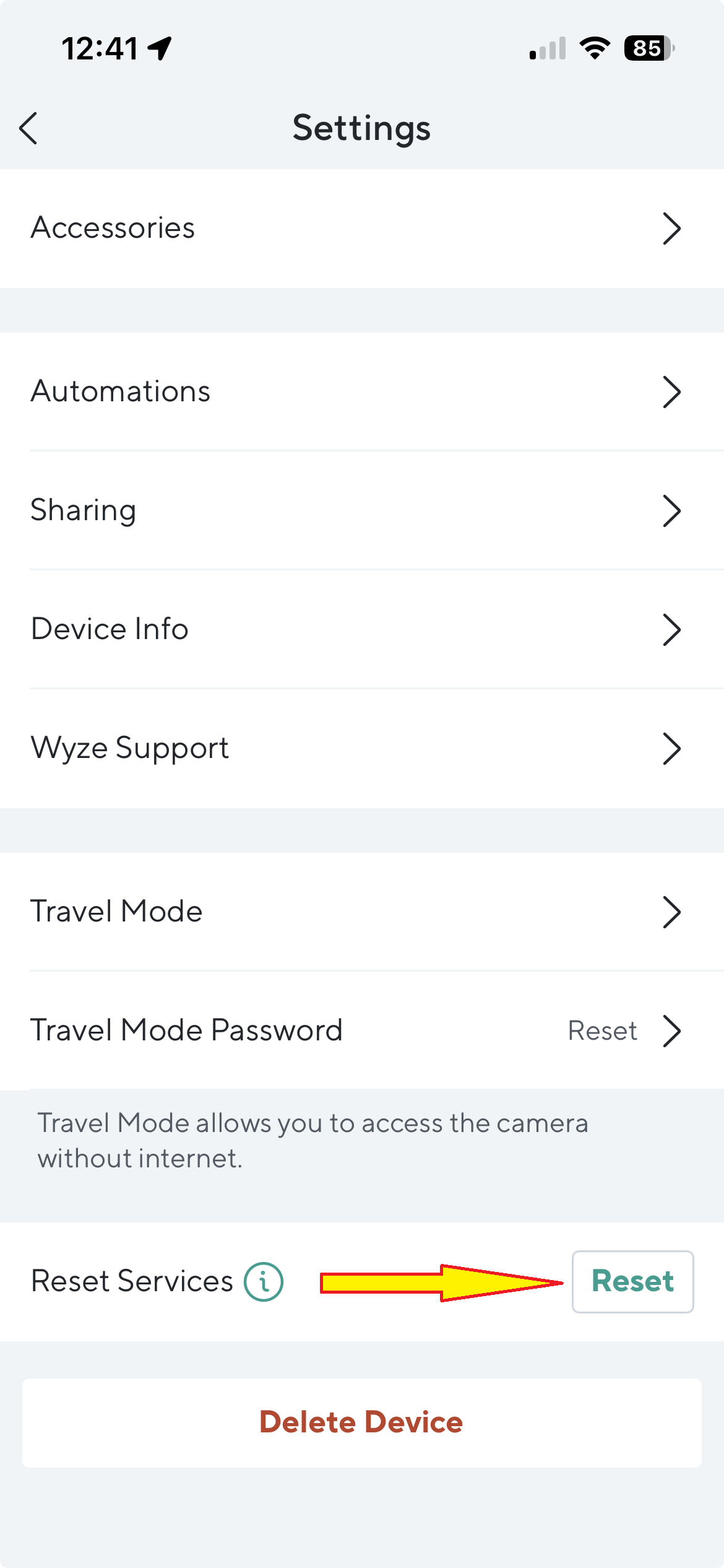

@PDSF What does the camera battery % show? Is event recording turned on and did you select smart detections or all motion? Since you say you have cam plus did you go to my.wyze.com , log into your account, then go to services and see if the camera is assigned to cam plus, you have to assign the camera/cameras to cam plus. You can try the easy way also, open the camera setting go to the bottom of the page and tap reset services if you have the cam assigned to Cam Plus.
