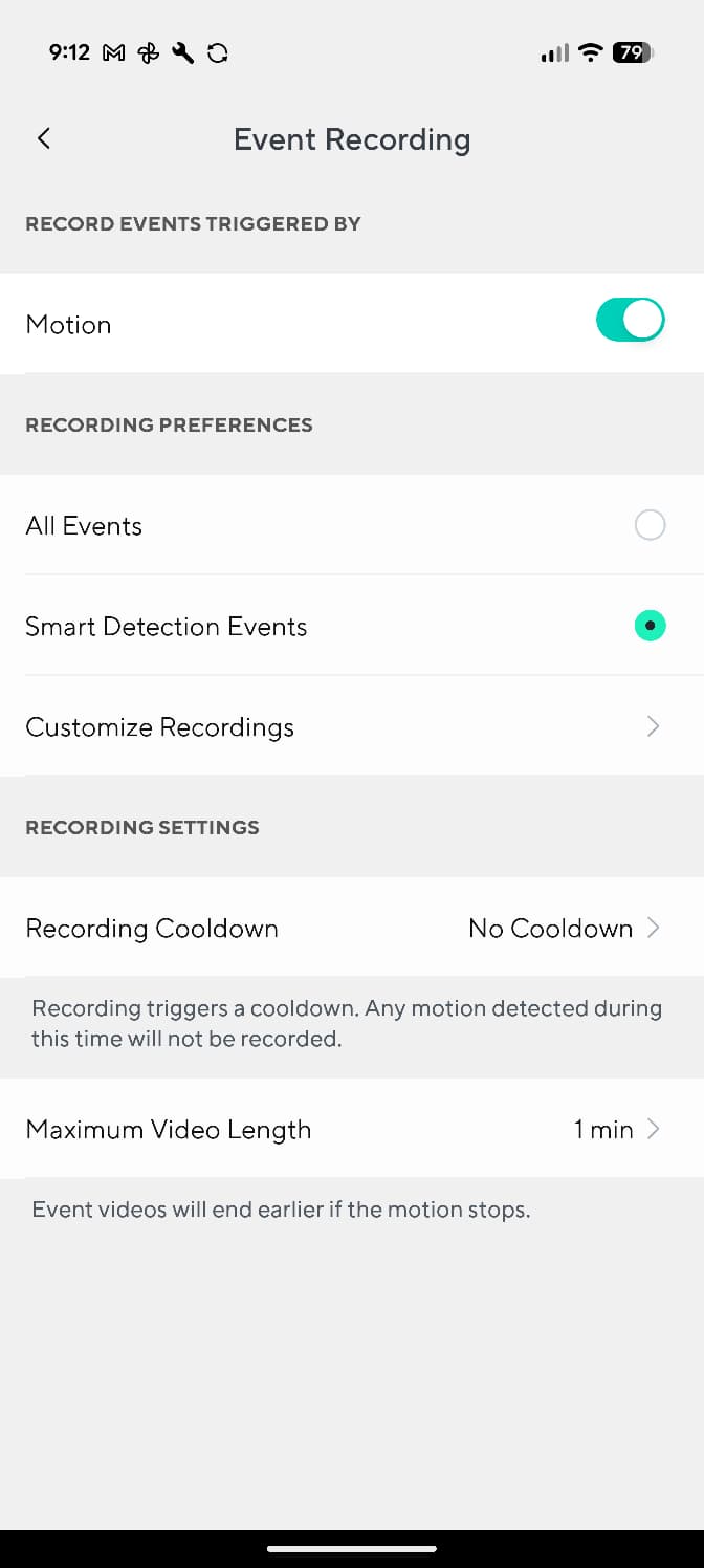

I was running it without a subscription, and am aware of the limitations of it. It became so frustrating that I’ve got a plan for this one camera, expecting it to “fix” the lack of notifications. The only difference now is that, when it detects something, it tags it and gives me a short clip of the event. WHEN it detects it.
It’s got a detection zone setup, distance set to 30ft, sensitivity set to 5, and motion tagging on. It’s set for Smart detection events, but I’ve tried with ALL EVENTS and the results are the same, mediocre. Under smart motion, the only thing off is “bird”.

Screenshots of all settings and even customizations for this camera:
I’m on Android 16, latest security update. Wyze up latest version installed, cameras all have the latest firmware.
