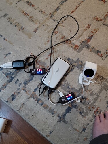

I’ve completed my testing of the Voltaic > Wyze camera testing. The test setup was:
UL approved extension cord > Samsung wall wart (normal, fast, and super fast capabilities) > Drok USB tester (charging indicator) > Voltaic v75 battery bank > Drok USB tester (discharge indicator) > Wyze OG-T camera.
Note: please don’t laugh at my ā€œPristine Test Labā€ (living room floor). The Test Lab manager (wife) is asleep and has given me full run of the Lab until 5am :rofl::joy:.
Following are 3 screen shots with my observations.
In this shot you can see the charging tester on the left, the discharge tester on the right. All looks proper.
In this shot the Voltaic is no longer charging. All looks proper.
Note:if you see a foot in the lower right hand corner that is me testing my ground circuit​:grin::grin:.

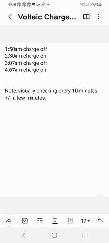

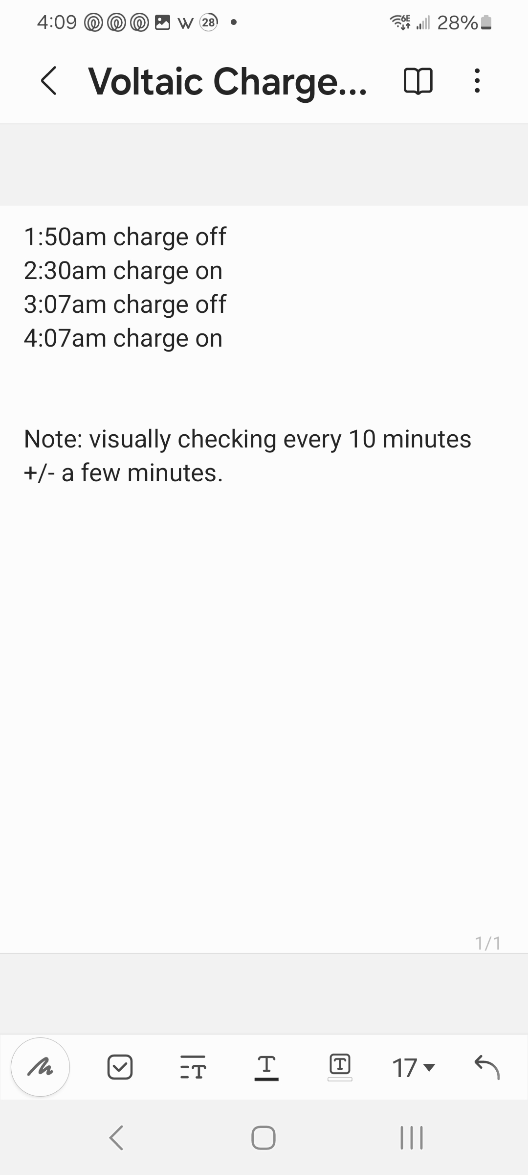

Now the big question - - What is the cycle time between these two conditions? Glad you asked.
The following shot shows the cycle time according to the Drok USB testers and time.
Caveats
The 4 LED’s do not reflect what the Drok testers are seeing. They are showing a fully charged battery. I’m guessing this is so a typical user would look and say ā€œI have a fully charged unitā€. The user does not need to know the unit is cycling.
The Voltaic unit does not have fast charging. This may become an issue as I determine how long the unit can operate with the solar panel. To date I’ve seen 3+ days. I had to stop that test to do this test.
Conclusion
I’m happy with what I am seeing. The unit does not sit on 100% charging. It cycles between charge/not charge approx every 40-60 minutes.
