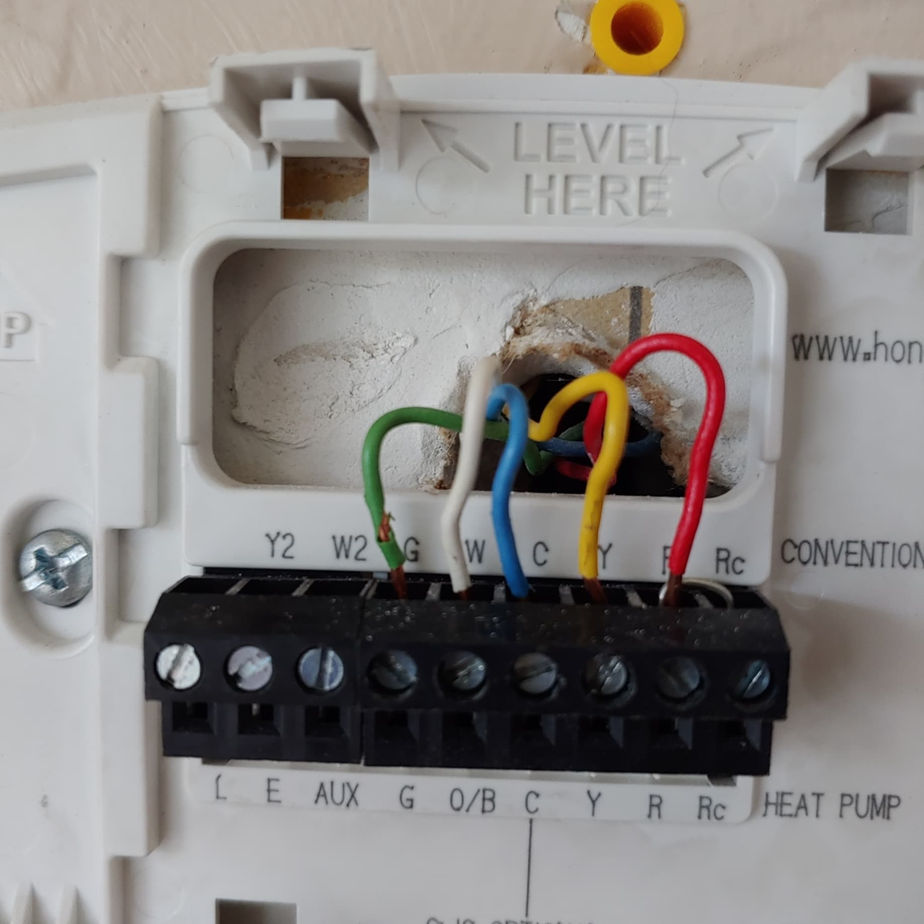

This is how my old one was wired. The new one is wired as directed WITHOUT a heat pump. Our system does not have a heat pump.
 ![Thermo Wiring](https://us1.discourse-cdn.com/wyze/original/3X/a/e/ae391a3a65e34c33fd2b04bcd24089b72186a812.jpeg)

Did your old thermostat use batteries?
If not, your wyze themostat might be defective. Did you use the C adapter?
Do you have a picture of the furnace side of these wires?

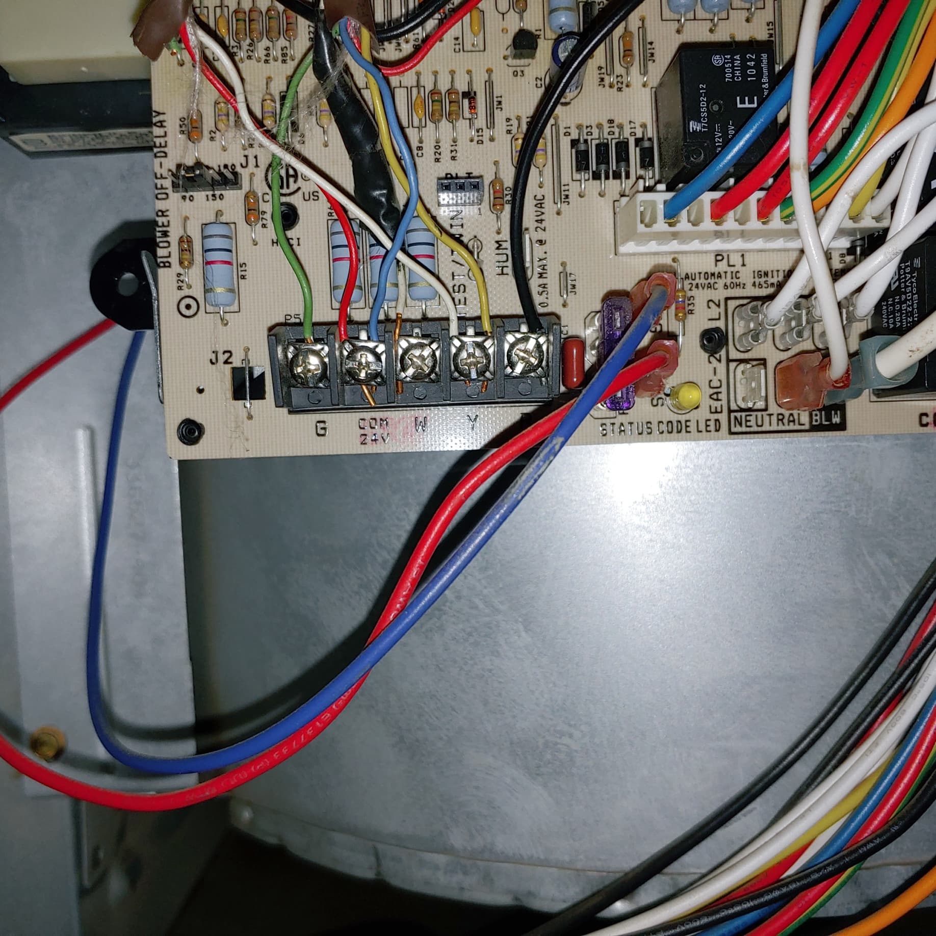

Okay!!! I FINALLY found the wires. They were back behind a sub-panel. Here they are.
 ![20211104_155516](https://us1.discourse-cdn.com/wyze/original/3X/6/c/6cf44708df7fdc0e037d6c7073e6b105986b4959.jpeg)
 ![20211104_155536(1)](https://us1.discourse-cdn.com/wyze/original/3X/f/c/fc81f20b870a3a131d7a5f99811456395f232101.jpeg)

Why is the W wire wrapped in electrical tape?
 ![image](https://us1.discourse-cdn.com/wyze/original/3X/5/4/546b8174c7328ca4135cf0bc54621378fcedab63.jpeg)

No idea. Nothing was ever said to me about it
