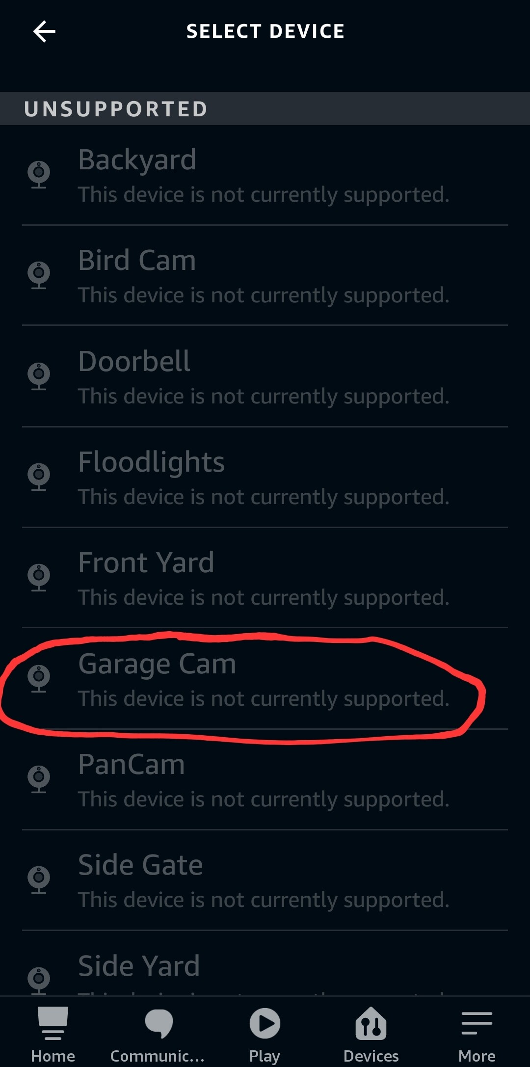

Has Alexa support been announced?

Alexa does work with the garage door camera. For example, I can get an announcement that a person has been spotted in the garage. But as far as I know, Alexa hasn’t yet found the attached gadget that works the garage door operator.
