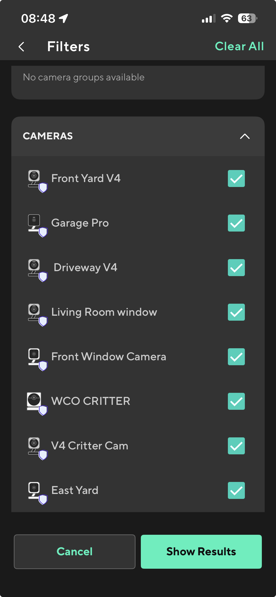

Are all your cameras selected to show events? On events page tap the funnel icon, scroll up until you see a list o cams and make sure they have a check mark in the box.
Alternatively, you can navigate in the app to the  Events screen and then tap  âžś Clear All âžś Show Results. If you’re getting to the Events tab by tapping the All Events button on a particular Cam’s or doorbell’s Live Stream screen, then the Events tab is going to be filtered for that particular camera when you get there. Without knowing more or seeing relevant screenshots, I would guess this is what’s happening, but you probably want to start by just clearing your filters.
I checked all of those settings previously.
I just checked again and it appears that on the 25th and the 26th, the two cameras were not showing events at all when there were events recorded by the doorbell video camera in the exact same area. There were no power outages and the cameras were plugged in. Very odd! :thinking:

Since you have tried clearing the filters, I would suggest trying to “set” a filter to see if that works. I find it helps me see some PET motions that have been recorded but do not show until I set the filter.
