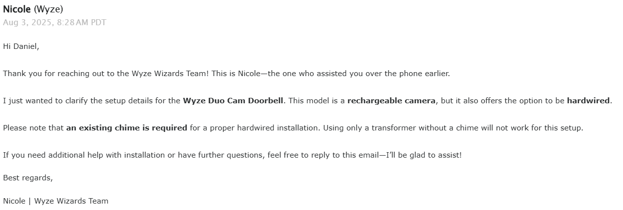

I’ve been using a Duo for a couple of months now. I recently contacted support because the 24vac transformer option does not work on mine. I installed mine on an old house that never had a doorbell, So I ordered a 24v transformer and hardwired it. The camera has run off battery power only and doesn’t recharge, I got the strangest response from customer support when I contacted them about this issue.
This makes no sense. 24v is 24v. I verified 24vac is present at the back of the Duo and the transformer is rated 40va. I’m not sure what to do at this point. Here’s a review from wyze.com about using the Duo with a basic transformer.

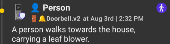

Below are the Descriptive Alerts on the Doorbell. Does Nest offer this type of notification yet? I am asking honestly. Not in a “gotcha”/sarcastic type of way. I’m dumb to Nest.
Edit: I did go look at the Nest Doorbell website. Seems they have People, Pets, Package, Vehicle, and Familiar Faces. Nothing Descriptive that I could find.
Not that descriptive, but it is almost perfect at identifying who it is that is walking up. John is at the front door, mom is at the front door. Etc.
It will say, a package has been delivered/removed.

I agree that it should be working with the transformer as you described, and the response seems to demonstrate a lack of understanding about the product. Even if you have an existing chime, what ships with Duo Cam Doorbell for dealing with a home’s built-in chime is a jumper wire that’s used to bypass the chime. :roll_eyes: If you want a built-in chime to actuate with a Duo Cam Doorbell button press, then they want you to get the Chime Controller and install that in the box.
If you’re sure that the transformer’s power output is adequate (the specs you listed make it seem so) and that the connections to the doorbell are solid, then I’d wonder about two things:
  1. Maybe try to re-add the doorbell to the app (possibly do a factory reset first), just to see if there’s some step where you have to tell the app that you’re wiring it. (I don’t know; I’m just speculating, because I don’t use Duo Cam Doorbell.)
  2. Open another ticket with Support. I like doing those via e-mail, because I can respond at my convenience, and you might get another Wyze Wizard who wants you to jump through a few troubleshooting hoops, but then they might offer to replace the unit for you, because I don’t think it’s doing what it’s supposed to be doing.
